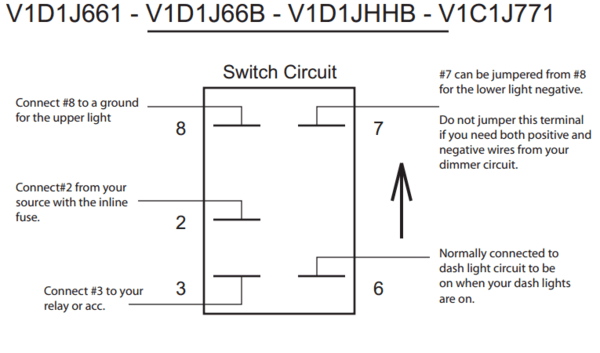

    Most of their switches aren't just the common power and ground....
    This is the diagram for my switches. Independent lower LED, dependent upper LED.

    Yeah I wired up some winch controls for another members truck with independent LEDs it was quite fun

    iIt was easy once I finally understood what each pin was for. Honestly my favorite wiring job haha

    What are you guys tapping for the dash lights?

    I used the wire to the bulb that's in the change holder. I removed the change holder and put my cb there, so the wire was in a perfect spot to route to the switches.
    You might not have a light in your generation Tacoma, so if not I'd tap into the shifter light.

    I used the power to the factory clock since I took it out and put my switches there.

    It has two 12v+ going to it...be sure to use the one that is only on when you turn your dash lights on lol. Unless you don't mind your switches being lit up without your other dash lights.

    Yeah, one to keep it's memory and one to turn on the LEDs I'm guessing? Haha
    Be easy enough to test for.
