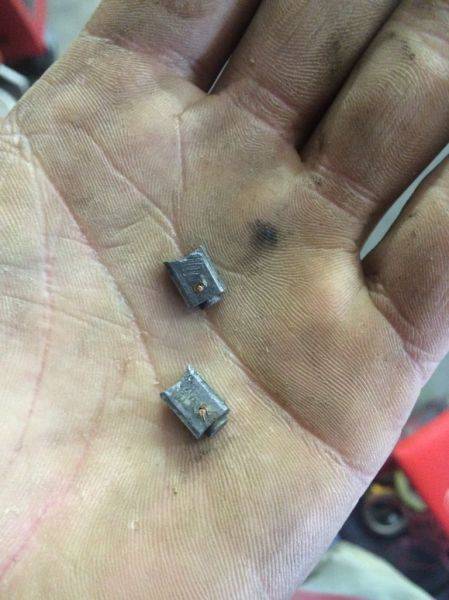

    Installed new brushes in my alternator. The old ones were pretty much done for, and the springs couldn't overcome the friction from the dirt in the housing. The new ones are about twice as long as these after 195k miles.
