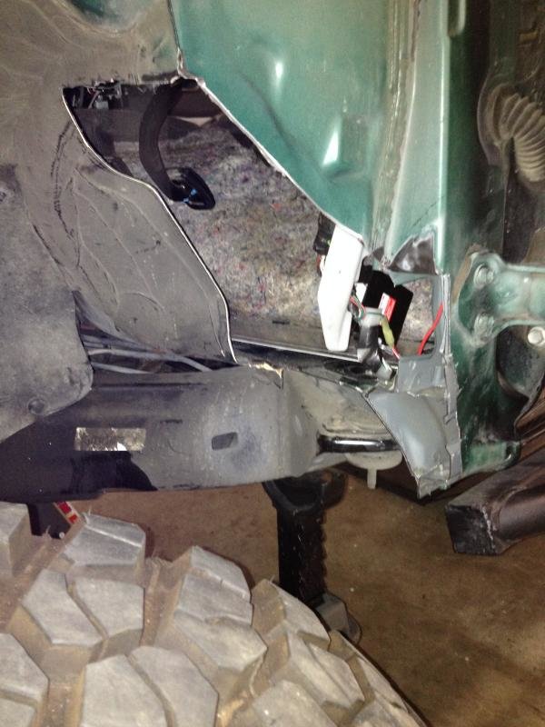

    Cut a big hole on the drivers side

    Man, every time i see one of you guys do tubbing for 315s i think...shit..shoulda just done that..the hole is always smaller.
    NAAAAAHHHHH
    haha :p
    looks good man! have fun welding!

    HAhahaha yeah it's smaller, and much more than needed, took the coilover out like you suggest, so this is full bump for the control arms, it won't be as flexible with the coilover installed right? In the shop I was comparing to yours as we were doing it and we didn't get into the A pillar near as much!

    No it is possible to get into your bumps easy even with the coilover in. Thats why you have to make sure it clears at full bump.
    Yea the a pillar part has to do with tire width, rim backspacing, and alignment.

    Gotcha well it clears I'm pretty happy so far, next is fenders!
