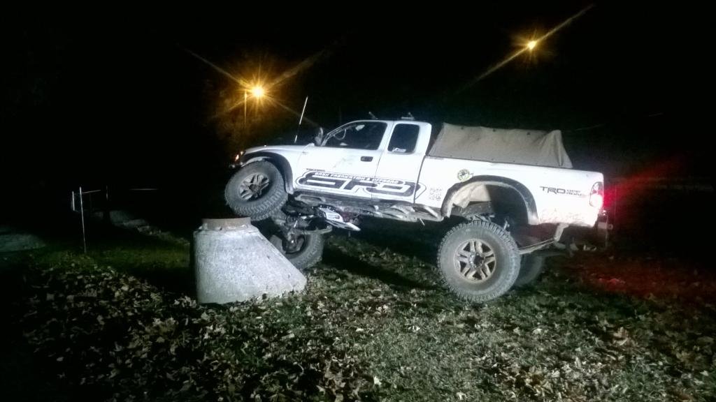

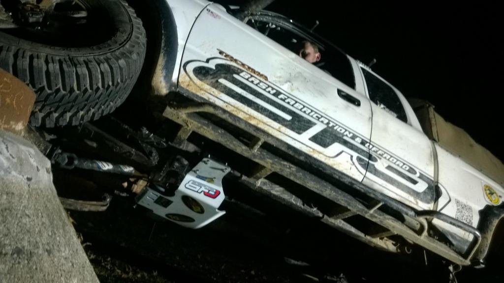

    Finally built my driveshaft and put it in 4wd for the first time in idk how long.. oh how amazing a front locker and twin sticks are... makes you forget you even have a rear locker..
    The skid is for overflow stickers that I have way too many of.. eh why not. Already gouged it in a few spots.. cant wait to go to Uwharrie next weekend!

    nice Chad....verrry nice ....;)

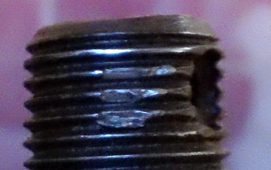

    Finally got around to replacing the LH LBJ today. Now both LBJs are in (Moog 555). But I had an adventure in it. I have been flipping the castle nut on the tie rods to tap against to help loosen the tie rod. Which I now realize is dumb, as I can whack the ever loving crap out of the housing since it is being replaced as part of the LBJ. Anyway, wound up doing this to the threads:
    Could not get the castle nut to tighten past that point without the rod spinning, and no amount of force to bind it would work. So, got to install a new outer tie rod too. Yay :) Since this has become my DD (my Camry is out of commission waiting on a throttle body) I had no choice but to replace it with a Duralast TR from AutoZone. Which is a tad longer, so I had to try to match up to get to sort of aligned. I can tell I am slightly cocked right, so I suppose next weekend I will take it off and do another clockwise revolution on it. Yee haw.

    ^^ I bought a puller from AZ, and the damn thing doesn't fit anything - tie rods, LBJ, nada. So, have to get the right one I suppose :) I just posted a thread about UBJs, so looks like I shall rent the three arm puller. My preference is to remove the knuckle and do it that way - I could also sand down and paint the knuckle as it is rusty - but I have seen some videos that suggest this is quite the job thanks to my manual hubs. I have some bad lug studs as well, so should bite the bullet and get it done. Damn cold weather and no garage to work in! I need to clean my garage stat so I can use it. Grrrr.
    But, as to the new tie rod - meh. 129k, original tie rods - might as well replace them. Will do the passenger side next weekend I suppose. If it is not insane cold.
