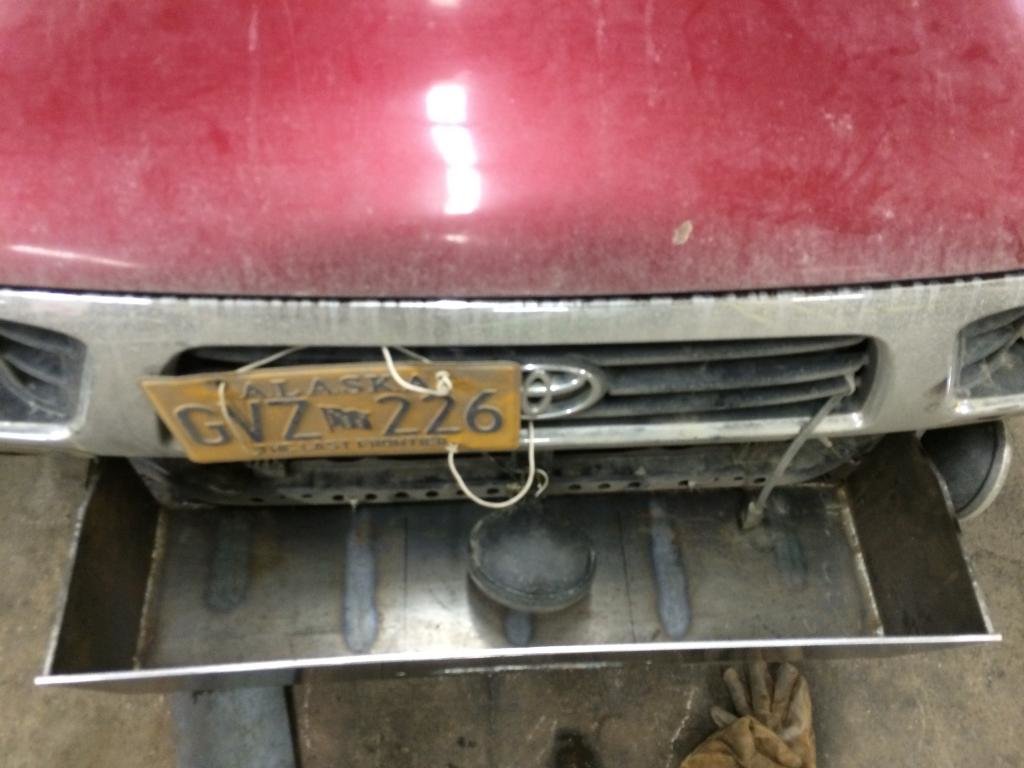

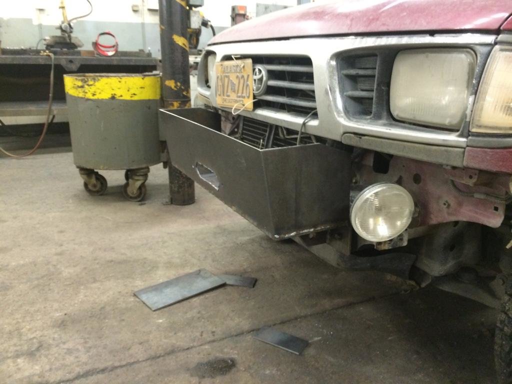

    Made some more progress on my bumper.

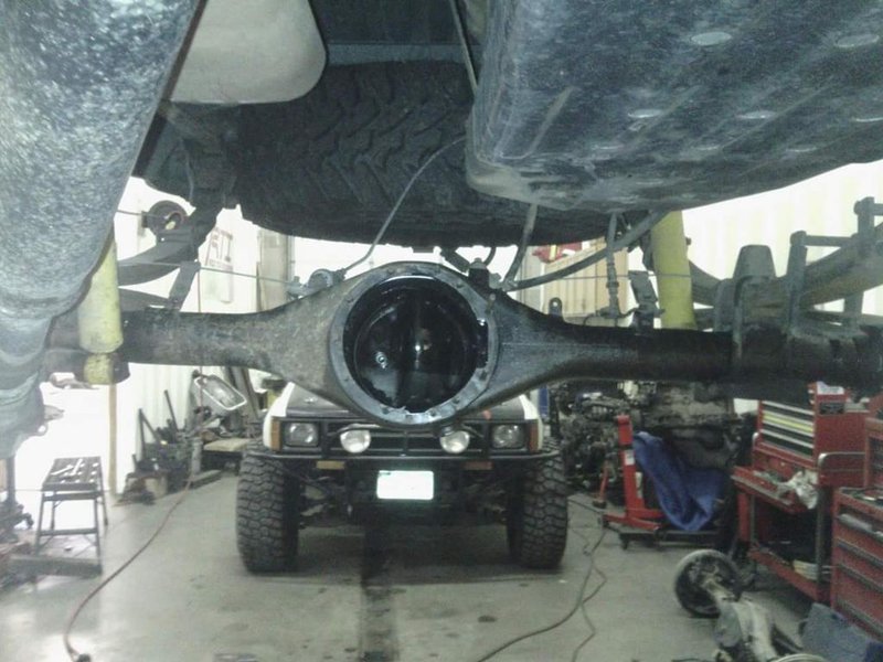

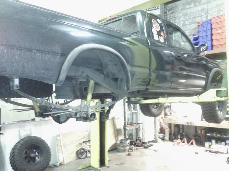

    Little elocker/4.30 swap action by RTI:cool:
