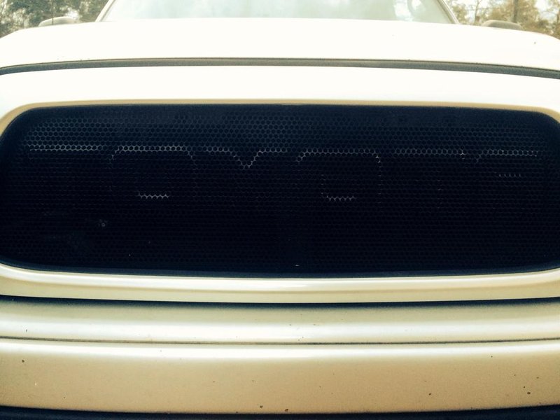

  8. Dec 19, 2014 at 2:21 PM
    WyoRoam
    WyoRoam Well-Known Member
    Jun 28, 2011
    #58997
    230
    Brian
    Sebring, FL
    1st HomerTaco Ghost Raptor Grille, Softtopper
    The picture doesn't do justice to the HomerTaco Ghost Raptor!
    I'll take more in the sunshine tomorrow

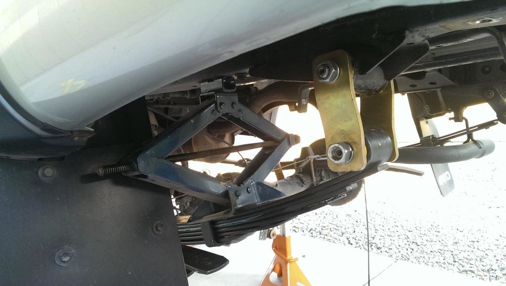

  14. Dec 19, 2014 at 3:57 PM
    Delta00
    Delta00 ᕕ( ᐛ )ᕗ
    Sep 16, 2013
    #112633
    4,137
    Troy
    Chandler AZ
    2002 Toyota Tacoma 4WD
    Check Build
    Got one dakar leaf pack in...
    What a pain for one pack, had to use a scissor jack to get it in position. (Bolts were fully tightened after this)

  16. Dec 19, 2014 at 4:03 PM
    Delta00
    Delta00 ᕕ( ᐛ )ᕗ
    Sep 16, 2013
    #112633
    4,137
    Troy
    Chandler AZ
    Check Build
    Me?
    Leaf pack did not want to bend down at all so the shackle bolts could line up. I used the scissor jack to push down the left pack and align the leaf pack with the shackle. Worked surprisingly well.
  17. Dec 19, 2014 at 4:05 PM
    Blackdawg
    Blackdawg Dr. Frankenstein
    Dec 31, 2010
    #48500
    81,652
    Monte
    Wyoming/St. Louis
    The Trifecta of Taco's
    next time..lower the axle...haha that could have been..bad..
  18. Dec 19, 2014 at 4:08 PM
    Delta00
    Delta00 ᕕ( ᐛ )ᕗ
    Sep 16, 2013
    #112633
    4,137
    Troy
    Chandler AZ
    Check Build
    Yeah... Brake line did not want to give anymore slack and I didn't want to mess with taking it off. I have an extended one coming in the mail. I suppose I'll consider dropping the axle fully for the other side...... It went really smoothly and felt firm, but yes it could have gone bad :eek:
  19. Dec 19, 2014 at 4:23 PM
    johnboyTRD
    johnboyTRD Well-Known Member
    Sep 19, 2013
    #112818
    3,226
    John
    South SF bay
    2003 Tacoma Double Cab TRD
    Full ome lift, nitro charger sports all 4 corners (rear shocks relocated), Dakar pack w/ AAL, 882 coils, diff drop, toytec 1" shackles, trail gear low profile front bumper, Tuff Stuff winch, bamf sliders, RAT skids, BAMF Bed Rack, Tepui Kukenam RTT, RAT rear bumper,
    Yeah, I used the factory bottle jack the same way :) makes that part easy breezy.
  20. Dec 19, 2014 at 4:25 PM
    Delta00
    Delta00 ᕕ( ᐛ )ᕗ
    Sep 16, 2013
    #112633
    4,137
    Troy
    Chandler AZ
    Check Build
    Sweet, i'm not alone :D
