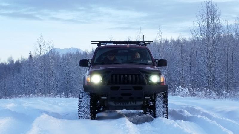

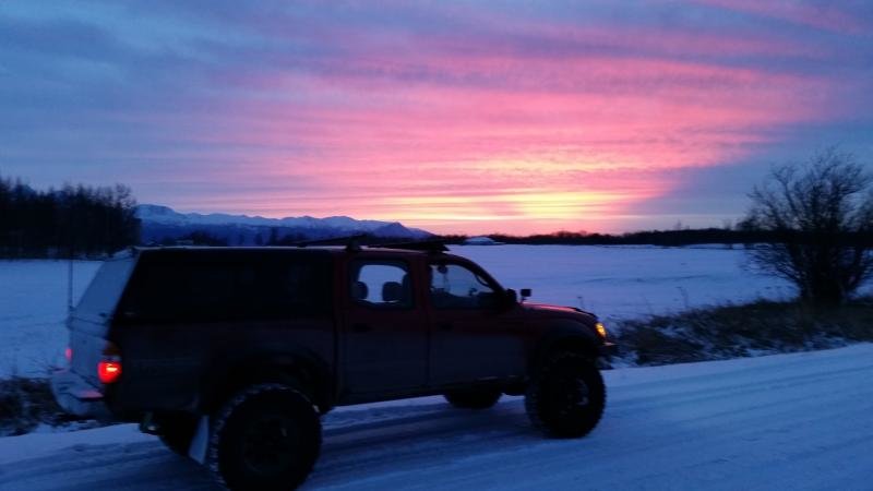

    Did some shooting and tested my tires in the process. They did really well in the snow!

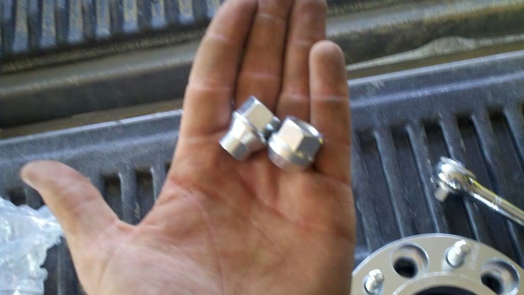

    those were definitely a necessity on mine with how the wheel is designed. had like 3-4 threads still showing with regular nuts

    Well Im not running them now. But new studs would be nice. Little things adding up

    Awesome pics!
    Duratracks? Mine did awesome in the snow, but suck now, about 40000 on them. Gonna go with copper maxx next.

    Bumper looks good Mike!

    Thanks! Yeah duratracs. They were awesome. Climbed a hill covered in about a foot of powder with no problem. Slow but they kept chugging along lol.

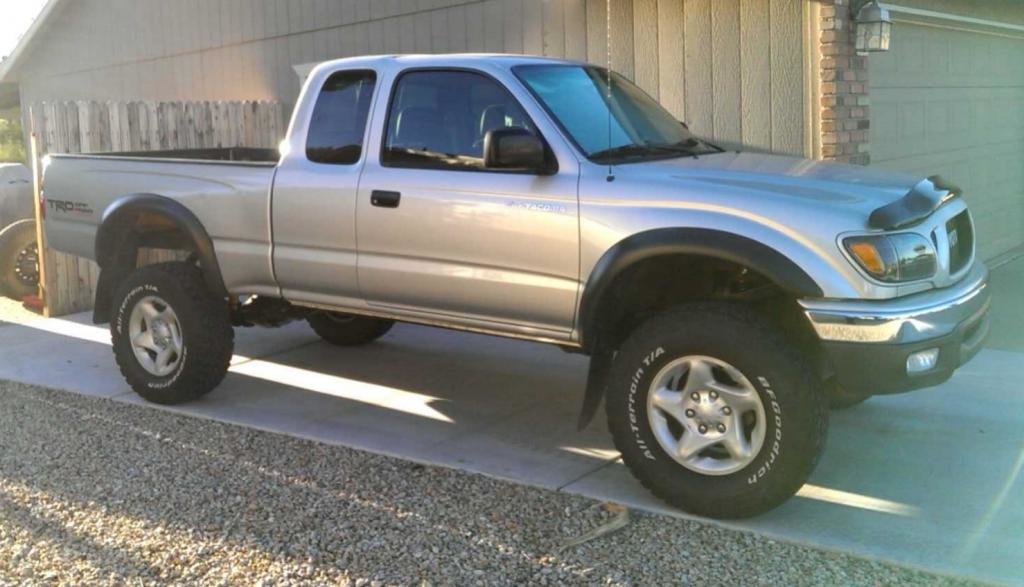

    Looks good. What'd you do for the rear? I thought you got bumpers? Or did they not come in yet?

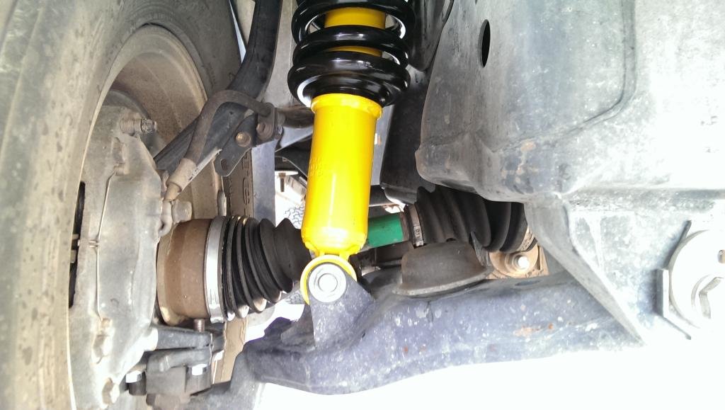

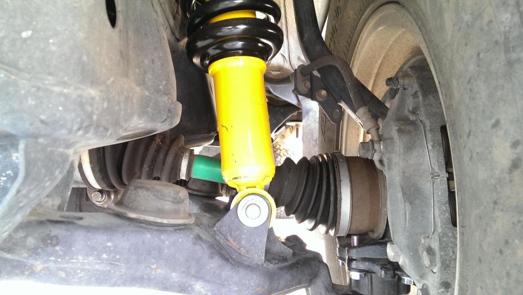

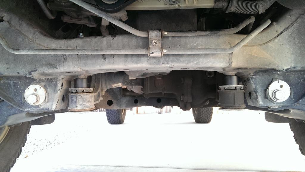

    Looks good. How are your CV angles with the 883's and no weight?

    Called fastenal and they said front bumper should be in Monday. Rear has a possibility of being done Monday also. So, bumpers hopefully on and painted by Friday.
    It's alright, I have a 1" diff drop on and none of the fins are touching, however a bumper is going to help a lot.

    Damn, no just looked out the outer. Remembered to look at the cv angles at night. I'll look tomorrow and see how bad they are. Thanks!

    Here are the CV angles and diff drop. So it looks like on the inner boot it slightly touches. Might go away once bumper is added.
