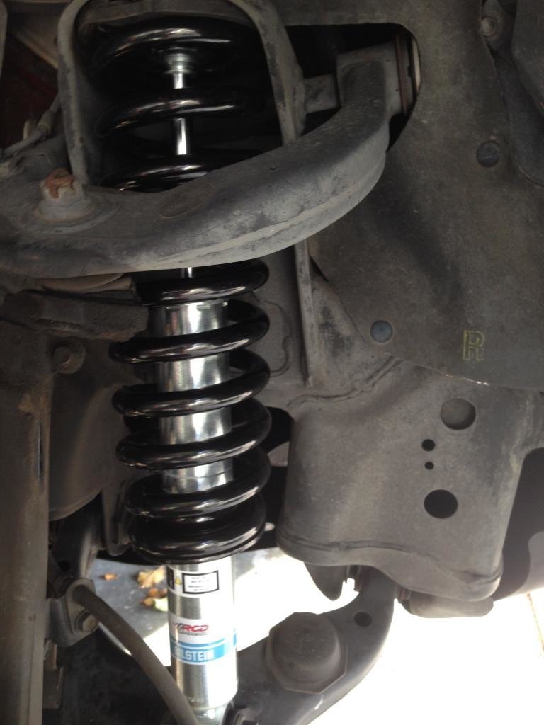

    Installed some OME 881's with 5100's on all corners on my 04 prerunner a few days ago. Much easier with the pre assembled shocks from wheelers offroad. Removed the 8 year old toytec spacer lift with oem shocks (god they suck). Only problem is that the rear of the truck is over an inch and a half higher than the front with my 8 year old Toytec AAL. Is it okay to just run the 5100's in the rear without the AAL?

    rake is better than bro lean.. but yes you can run the 5100s in the back with stock leafs, AAL dont usually change your range of travel..

    Actually 5100s are too long for stock leafs. You can get away with it. Just no offroading.

    Don't you have to get the 5125. That's what I have with stock leafs.

    Yea you have to get shorter 5125s

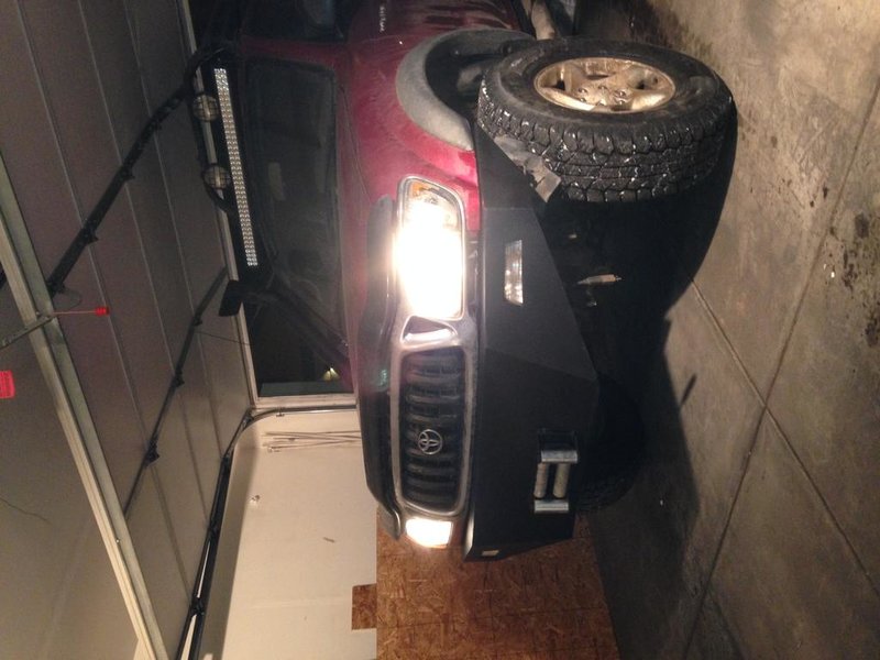

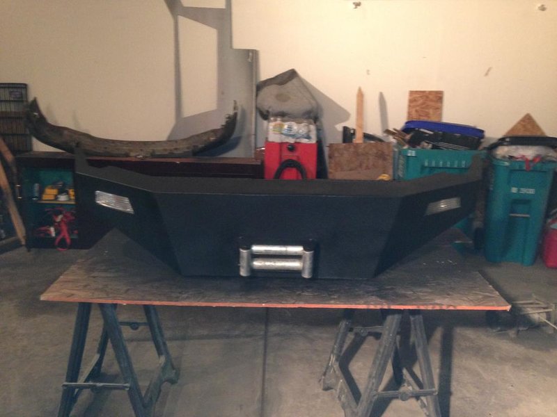

    Here's my last 4 days. Been needing a new winch bumper but wasn't going to shell out $500. Had to build it big to fit my 12000 lb winch haha, but I like the mad max look.
