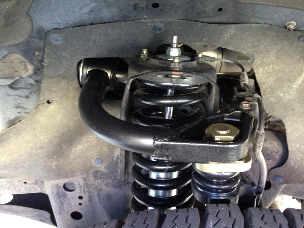

    Installed SPC UCA's. Pretty easy install except that I had to go rent a pickle fork to get the ball joint off of the UCA. Beating on it with a mallet for an hour did nothing. 3 jaw puller was a life saver at removing the ball joint from the spindle as the rental ball joint press was too long and awkward to use. Alignment results after a visit to the local shop were 0 camber, 0 toe, and 2.1 caster on both sides. Quality product for a good price (370 shipped on ebay). I thought I may be able to get away with not installing UCA's but with an OME 881 lift the best alignment results were 0 camber, 0 toe, 0.5 caster. Rode like crap.
