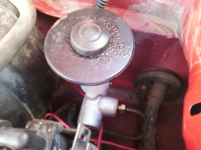

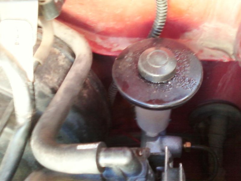

    Installed a new master cylinder. I don't have any pics of the installation but here's some of the new cylinder. It wasn't that hard to get in but it was just a PITA working in such a tight space.

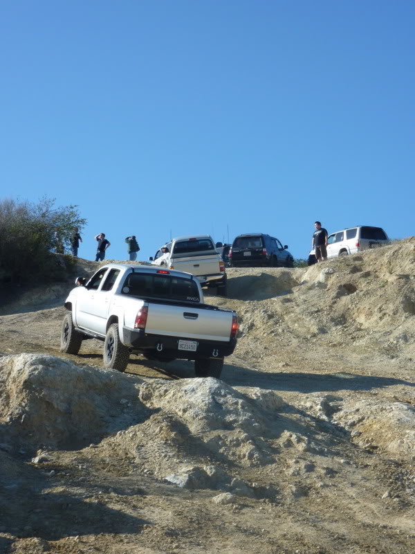

    You don't need no locker
    I kept up with these guys just fine. Took me a little longer but i made it to the top. :p

    It was giving out. My truck would have a hard time getting into first and reverse. Also my clutch is OEM with about 114k miles so I also changed it in hopes that it would help prolong my clutch life. It was pretty cheap i think i only paid like 25 bucks for it. I guess well see what happens but now my truck shifts smoother but is definitely gonna need a clutch replacement in the near future. Any suggestions i has a V6 3.4L?

    It didn't take all too long you should be able to get it done in within three hours easily. I had to move the vacuum box that rights in front of it cuz the lower bolt is nearly impossible to get to unless you have a swivel for your ratchet. On mine the end piece on the rod of the new cylinder wouldn't fit in the hole, so i had to unscrew my old one and put that on. The hardest part is probably adjusting it to your clutch pedal, there isn't much room to work under the dashboard so be prepared to squeeze yourself in. Just be sure to have a buddy around to help you bleed the new cylinder.
