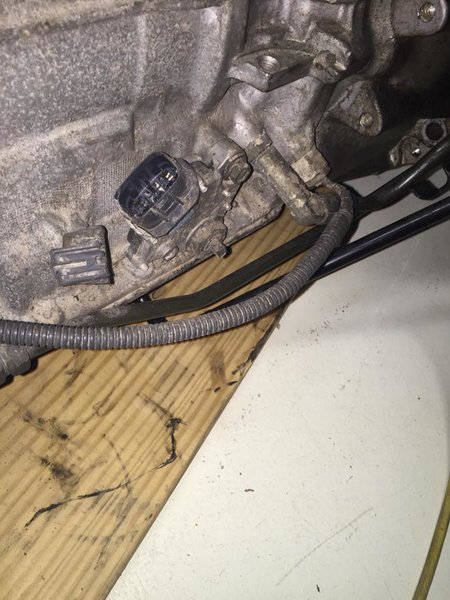

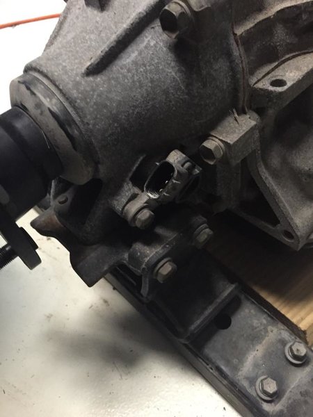

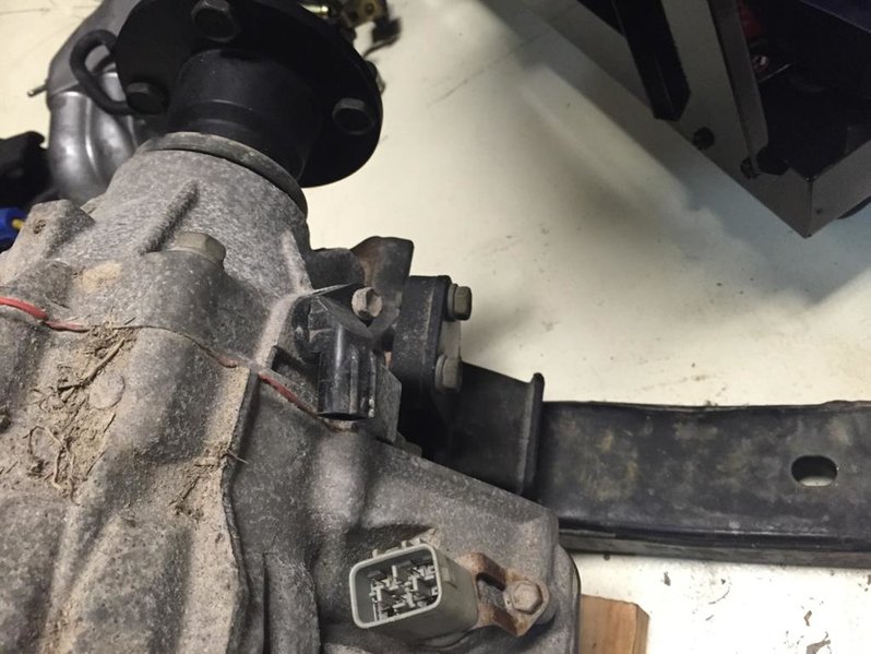

    Working on my 4x4 swap and just trying to figure out what the two plugs are on my 2wd transmission tailshaft
    Trucks a 2003 double cab a340e transmission
    I know at least ones a speed sensor
    Does anyone have a clue what the other is
    Any help is greatly apreciated
    Thanks in advance

    VSS (Vehicle Speed Sensor) and PNP (Park/Neutral Position) switch.

    Sweet thanks for the quick reply
    If you dont mind me asking since i spent quite a while searching before asking
    Is it in the fsm or where did you learn about it or did you just know?

    And not trying to argue but just making sure i thought this was the pnp

    On the output shaft extension housing you have the vehicle speed sensor on the passenger side, on the drivers side you have the output shaft speed sensor. The output shaft speed sensor is used for transmission control while the vehicle speed sensor is used for vehicle speed detection (spedometer and engine control).

    Ok i gotcha so are both of those plugs on the transfercase that im swapping in place of them?
    I know only of one vss on the tcase not sure though?
    Thanks

    Yes, that is the park neutral switch.

    This.
    The PNP is the plug that's behind the trans cooler lines.

    The VSS will move to the back of the t-case. The output shaft speed sensor should stay in the same general location. I have never done 2x4 to 4x4 swap so I'm not sure what wire change lenght.

    Alright sweet
    Really appreciate both of yall helping out really cleared alot of confusion up for me
