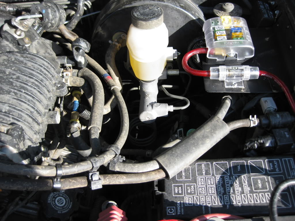

    Old picture before I melted the AGU fuse holder and swapped to a breaker:
    Well....he's right ya know.

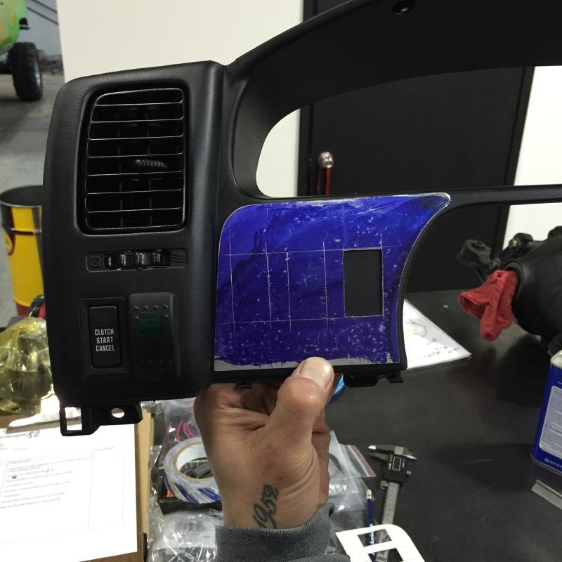

    Switchesss, front & rear lockers, compressor, move dimmer elsewhere

    I want to put my train horn and compressor switches here! but diff lock and dimmer are taking up my space :(

    I removed my dimmer switch to make room for aux switches. It's just a potentiometer so if you just cut it out and connect the two leads you'll stay on full brightness which is what I always had mine set on anyways.
