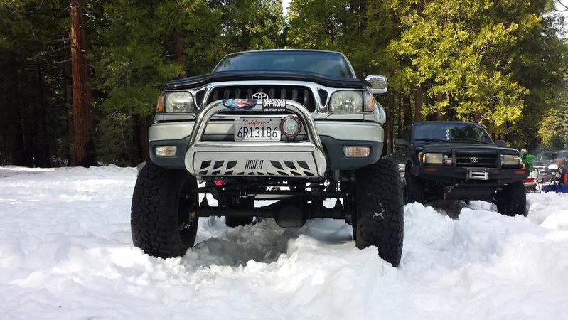

    Your front bumper is a killer you custom made it yourself or got it from someone?
    I want one for my taco

    Tyler at Pelfrytbilt made it.
    It was a one off so good luck, :(
