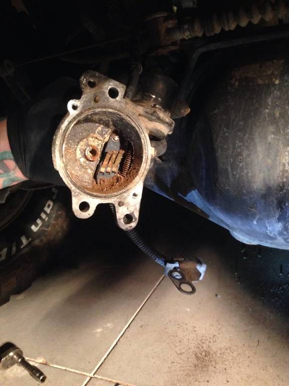

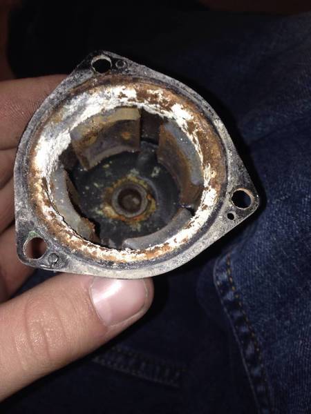

    Fixed my rear locker today, it was nice and crusty inside
    Sorry for the huge pictures.

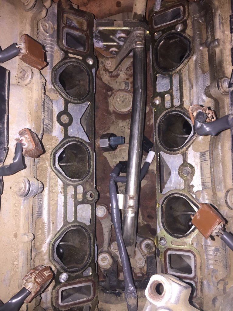

    Took less than an hour to get down to the knock sensors this time. Hopefully this new sensor does the trick. There was some dirt in the plug of the old sensor so maybe it was trippy.

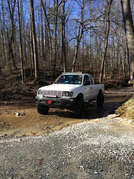

    Went ridind

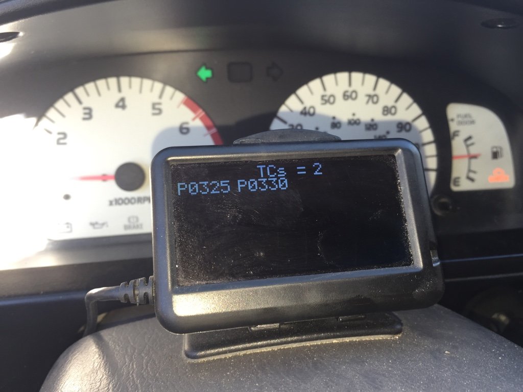

    Sweet. Now I'm throwing codes for both knock sensors.

    Strange. Maybe the harness is messed up somewhere? Maybe the connector at the ECU has a loose connection or something. I know when I soldered in the wires for my 7th injector, I was afraid I was going to mess up other connections while pulling on the harness and stuff.

    After reading a lot and finally understanding exactly what those knock sensors are doing, I'm almost positive my engine is done for. As the knock sensors detect knock, they retard the timing. Exactly what is happening to me at about 3000 rpm or more pulling up a hill. The timing is retarded so much that it starts flat lining and cutting power. If I stay in the gas long enough (which I have to because I have no power), the CEL will come on. Guaranteed. It will also come on randomly. I think I'm just driving around pinging and I can't hear it. So my conclusion is the knock sensors are good, the engine is bad.
    I guess I will put the supercharger up for sale and look at engine options. I would like to do that 6bt but damn it's a heavy engine!
