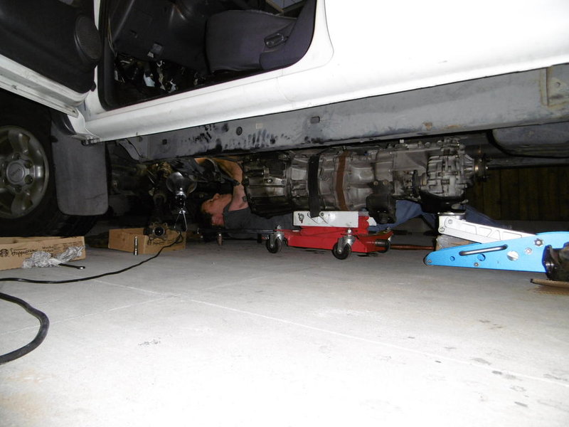

    Finally got my transmission pulled out last weekend.

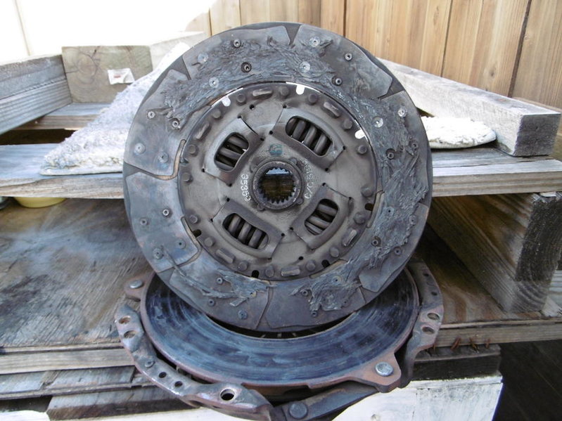

    Nice disc, eh? :eek:

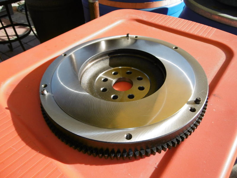

    Picked up the resurfaced flywheel yesterday, received a new center support bearing in the mail from AZ Autohaus as well.

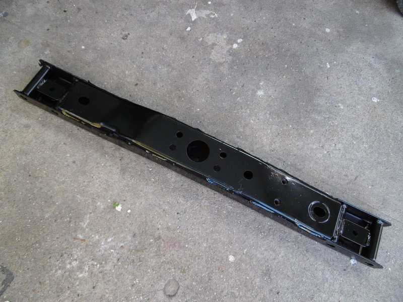

    Cleaned up and repainted the trans support cross member (had a little rust at the outboard mounting locations.

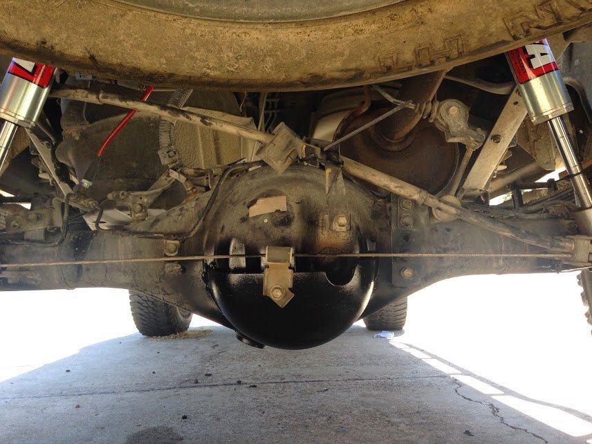

    as for armor, ive torn the crap out of the bottom of the diff, little black spray paint and bam! good as new. the tg rear armor does its job, protects the thin metal behind the ring gear. cheap and no "flamboyant diapers"

    x2. the bottoms are pretty strong. this is a nice and simple solution

    Do you have other angles of that TG rear diff armor?
    I'm curious of how much of a PITA it is to fill the rear diff. Also does that armor just drain out the hole cut for the drain plug (eg water, mud debris, etc)?
    Also, maybe it's just an illusion but it seems to be hanging below the pumpkin quite a bit.

    Drain the oil first...then weld.

    I like using the 8" pipe cap as diff protection. 20 bucks for one cap enough to do two diffs.

    I generally leave the oil in as it helps keep the diff cool and not warp. however, you dont need to fully weld these things on. a few 1" welds is all thats needed.

    You're not going to warp it at the pumpkin.
    I drain so the heat penetrates and doesn't get cooled premature from the oil in the housing.
