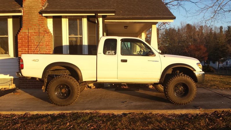

    What coils up front? I have 883s. Dakars and AAL. Lift was put on last April. Ran my bed rack and RTT for 6 months before I put extra leaf in. Added it. Then took the rack and tent off. This is what I ended up with. Only about 1 inch difference now. My suggestion would be run it another month and get some serious miles on the leafs. You'll be surprised how much they settle. Sorry for the orange picture. Sun was setting.

    Yeah, 883s. But I also have a plate bumper on the front which brings it down a bit more so the rake looks more exaggerated.
    I guess I keep em on longer to see if they settle anymore...
