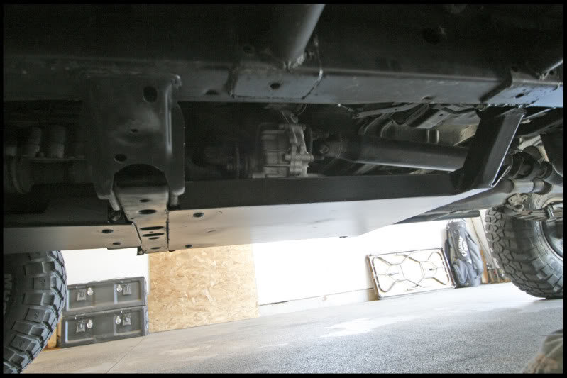

    Ehhhh....I disagree.

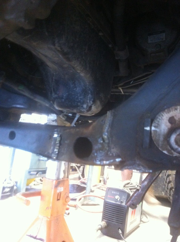

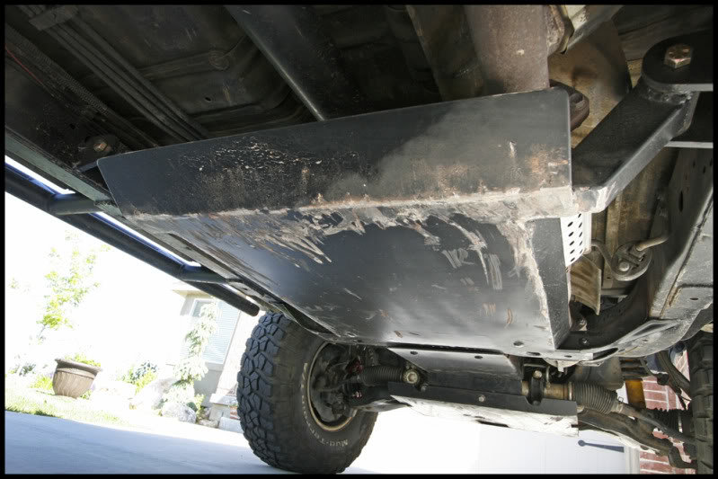

    I have BB IFS and bellypan skids. The bellypan design leaves a lot to be desired. I banana'd it the first time I used it...and yes, 3/16" steel. It's a LONG run between the rear tube x-member the skid comes with and the factory transmission crossmember. High center on it and it banana's. Well known problem if you search around. I beat the shit out of it with a 6 lb sledge and had a semi truck drive on it to bend it back as best I could. I welded in strips of angle iron as gussets, which helped. But even over the years it's banana'd more and more.
    The IFS skid is ok for what it is. I don't particularly like the design on it either though. In the front, there's a 90* break (see below) that does not weld back up to the side wings. If you lawn dart (as I have had happen in spirited offroading), that break wants to bend out. Also, the rear mounting for the front skid blows goats. It uses the factory steering rack mount. You keep hitting it...and the whole rack mount bends. I had to cut the entire thing out and build a new one out of 3/16" plate. Again...see below.

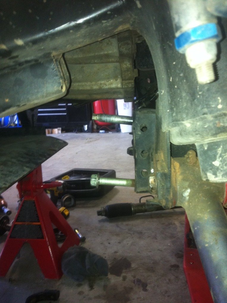

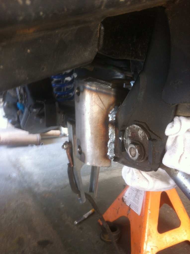

    Bent to shit steering rack mount:

    ^^^ wow. what were they thinking mounting the rear of it like that. thats alot of horizontal force on those bolts.

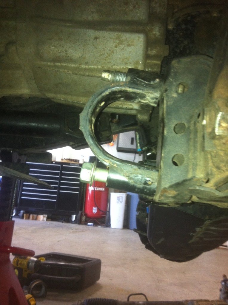

    Like I said...blows goats. It's like opening a can of soda.

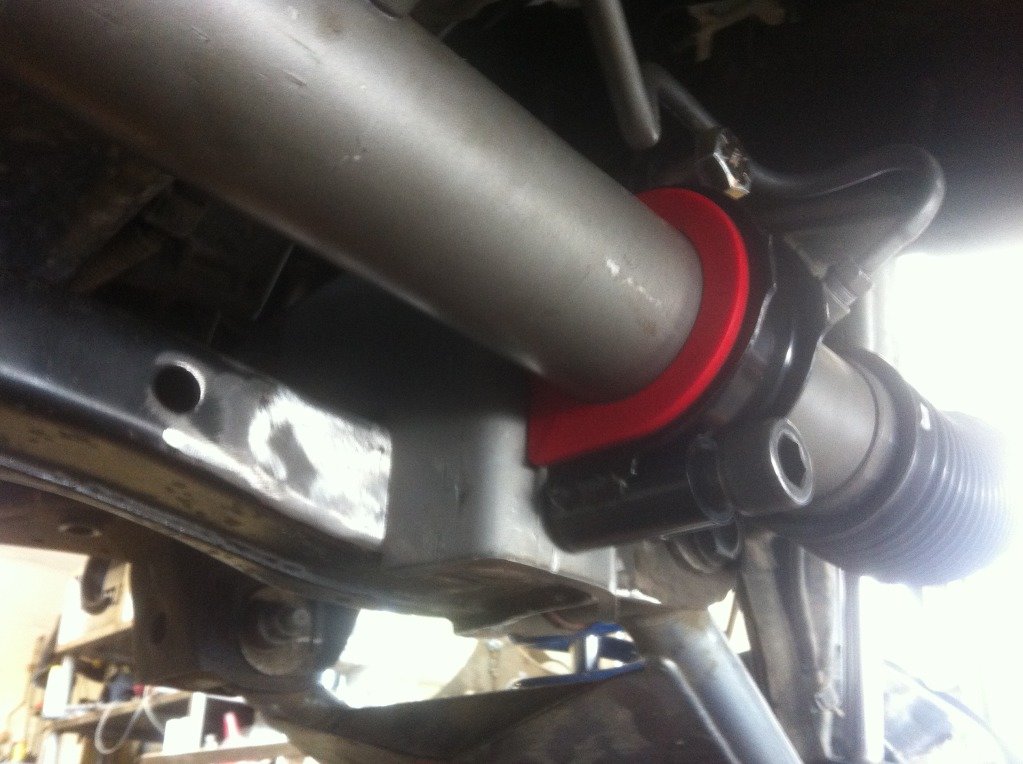

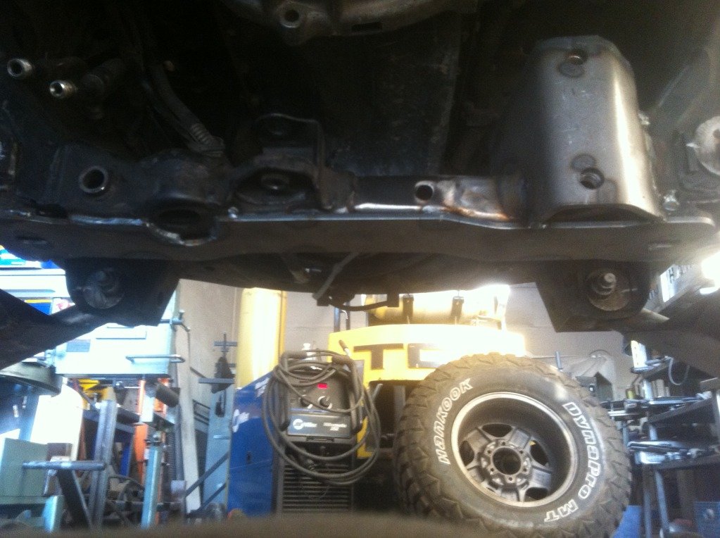

    It also exacerbates a not-so-well-known problem with that U shaped bracket that holds the rack to the crossmember. Believe it or not...those two bolts are actually two different sizes, even though the bore on the sleeves are the same size. One of the bolts fits super loosey goosey. Add in stress from a skid plate and the whole bolt/bracket bends.
    Rough day to say the least:

    Don't get me wrong, both skids have done their job. But some more thought into the design would have saved me a lot of work in the long run.
    Obligatory beat to shit skid. Beat so much, the arms from the front diff have actually punched through.

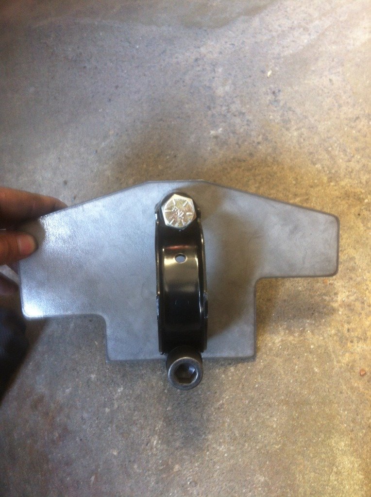

    They are light years better than stock. But I agree 100% the steering rack mount is terrible idea. I beefed up my Bud Built IFS skid and made my own Belly skid. I have beat them pretty hard. They have held up ok. If I didn't beef up the IFS skid it would not have lasted this long. If you do any serious off roading you need to add gussets and strengthen them up for sure. I am not doing any high speed stuff or jumping my truck. Just a lot of rock crawling and slow speed impacts to the skids. But the will bend even with the all the added support I put in my skids.

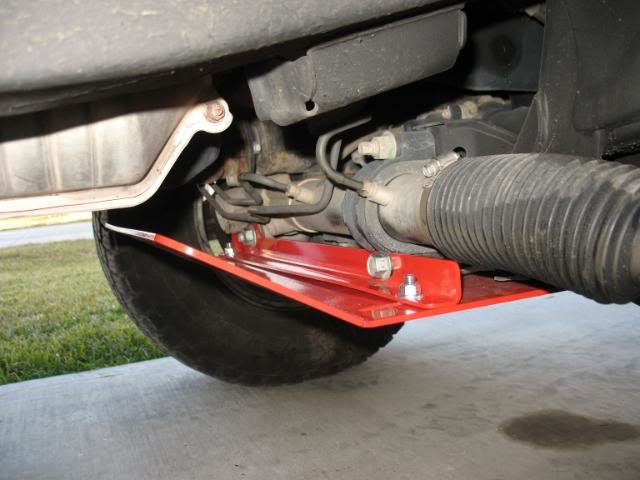

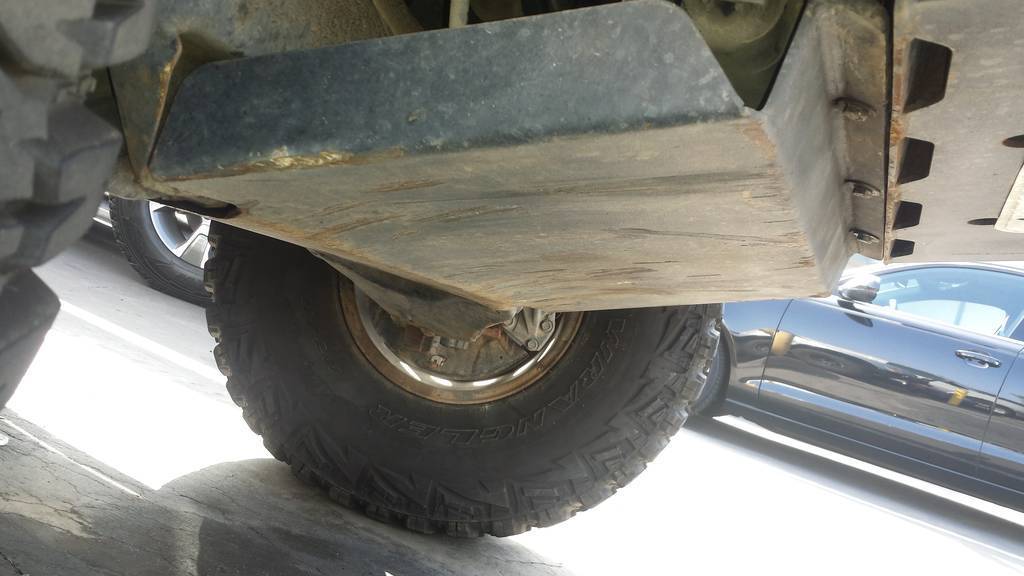

    I agree with you on the front.
    The bellypan however...doesn't get touched with high speed shit. It's only been crawling and the weight of the truck. The design sucks.

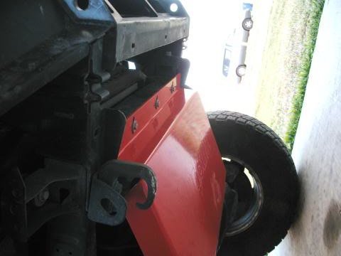

    Perfect picture of what I was trying to describe with the wings not tied to the 90* break where it bolts in.

    Damn i wish i could have done that when i exploded my steering rack mount.

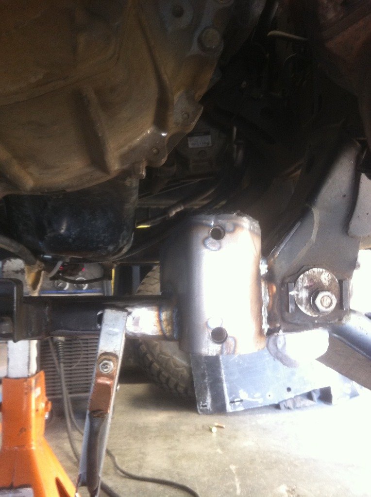

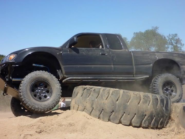

    Or you can make your own skid :) mine takes lawn darts, rocks while lawn darting, lawn dart whoops at 40+ etc etc and I actually use my skid plate to lift my truck all the time and so far just cosmetic damage and a little bending, but I also built my truck with the intentions of pounding the skids so I backed the plate with tubing tied in and gusseted all the way around the LCA mounts

    That is one area I wish I would have added plate. I still can if I get a wild and pull the skid.

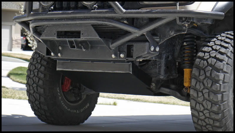

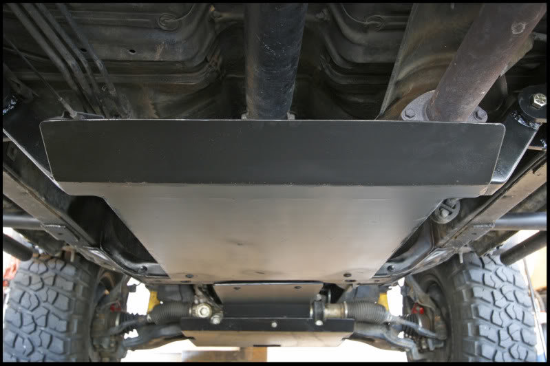

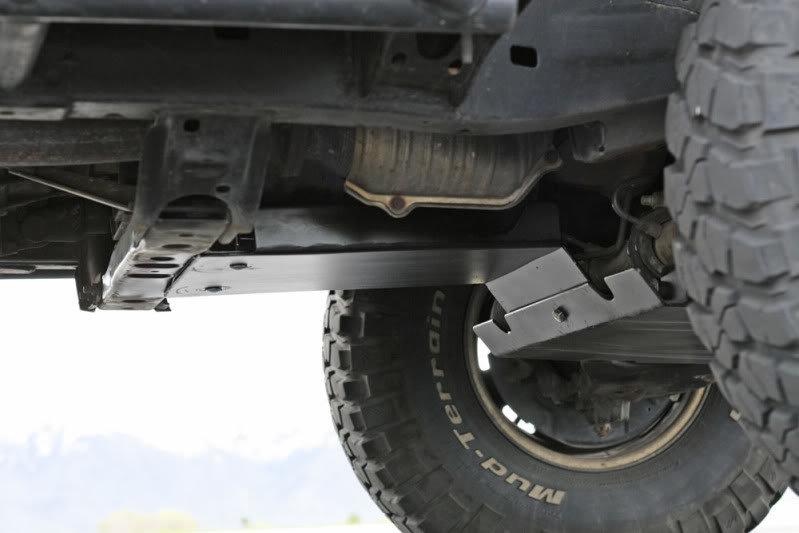

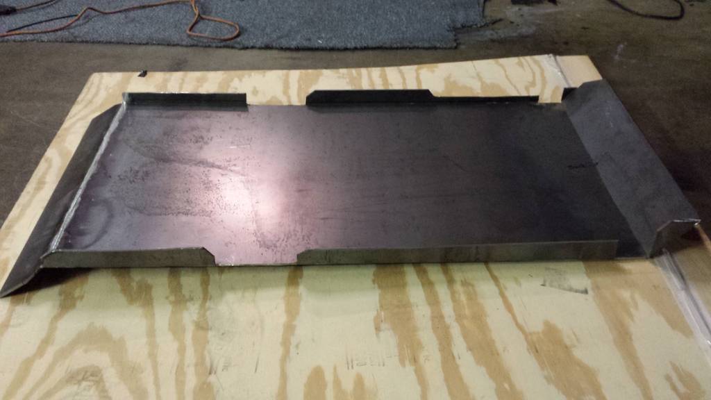

    I agree with Jason on the skids. It was a big reason I built my own (as well as it was a whole lot cheaper to build my own). My mistake was I have the rear of my front skid mounted to the steering rack like the Budbuilt. It's definitely not ideal and I will change it eventually, just haven't done it yet.
    If you build your own, closing up that corner at the front like Jason said is important, as well as some bracing on the backside. Rather than use a single piece belly skid like the bud built I used two pieces so it didn't need to span as far of a distance. I used the factory crossmember and added a bracket to the front and backside of it. The transmission skid is attached at the crossmember and then to the back of the front skid. I don't think I've ever even touched the trans skid. The belly skid starts at the rear of the crossmember and then has another beefy crossmember at the rear behind the transfer case. It also has bracing on the backside. I have come down extremely hard on the belly skid in the rocks and other that scratches it's still straight. The shorter distance and the extra bracing is key.

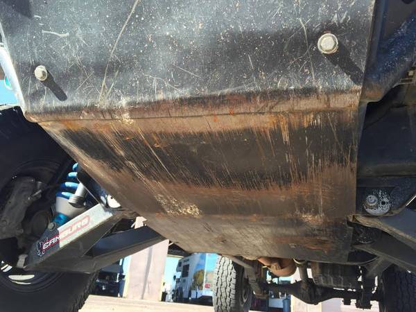

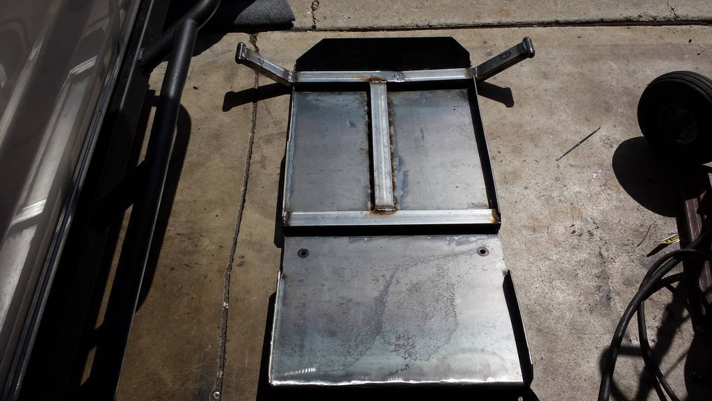

    here is how I braced my belly skid. 3/16" plate and 1"X2"X3/16" tube.
