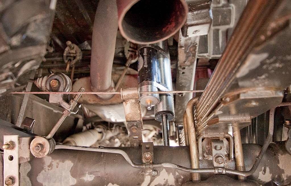

    18" here, dumped after the axle. Very nice sound when I'm on it, almost silent when I'm not or when cruising. Center/center, 2.5". This give you the most tuck up out of the way. Will require a slight "s" tube in the front so it is up high and lines up. Part #11246.
    Don't have a pic of the front but here's one from behind.

    That was the reason for going with 2.5". No downsides that I can see. The pipe before and after is still stock so loss of back pressure due to the 2.5" size seems unlikely.

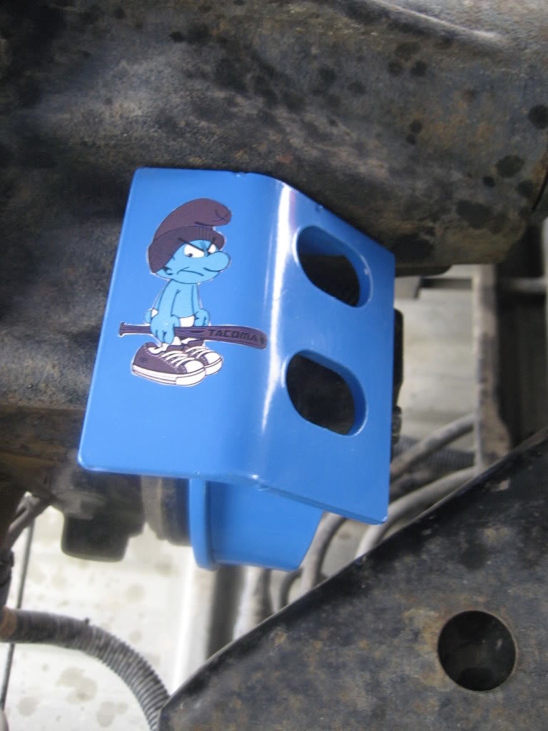

    I like your blue locker skid plate (or whatever its called) :p
    see what I did :D

    Oh my smurf skid?
    That was the inchworm e-locker actuator skid plate I had back when I had an e-locker. It wasn't a diff diaper.
