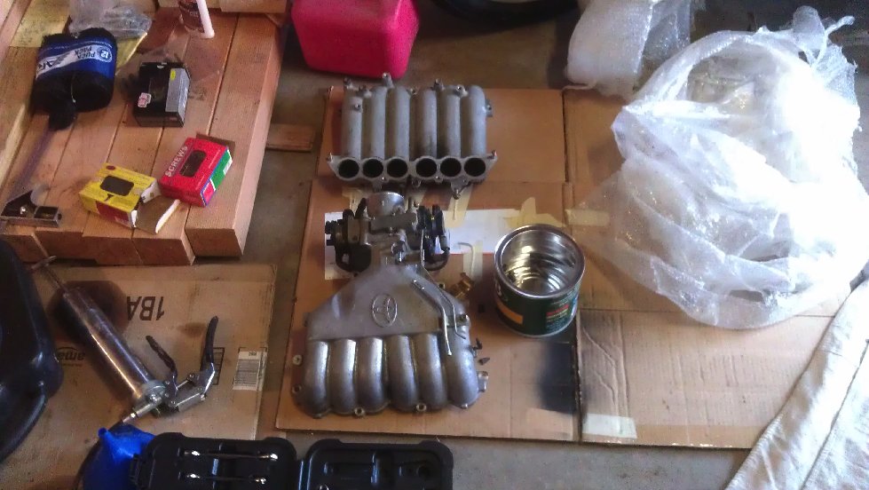

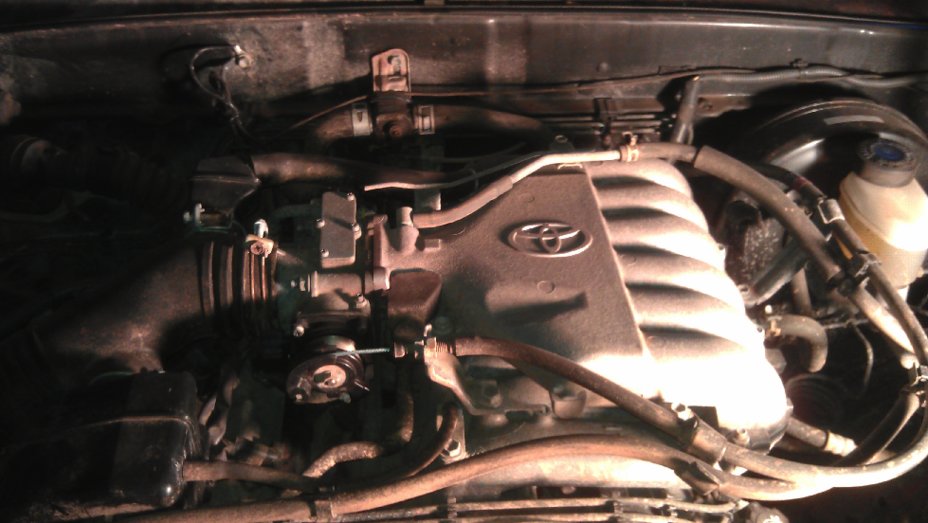

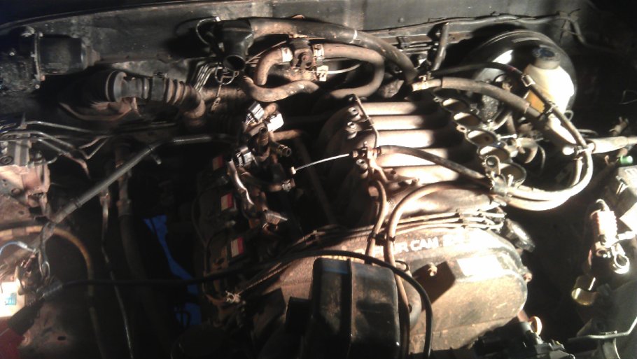

    Weather was nice today, finally got around to fixing my TPS issue. in colder weather it'd throw a CEL 2112 and about 3 others, all relating to a faulty tps. In 03 and 04 the Tacoma's run throttle by wire so instead of a 30$ TPS sensor swap like it should be, you have to buy a whole new reman'd throttle body for ~$500. The 'pump the pedal 100 times trick' sort of stopped working as it got more worn/colder. I found a guy on a forum parting out his total'd tacoma with ~48k miles on it from a salt-less state.
    Bought his TB for $50 shipped, and he included the intake manifold as well.
    Swapped it out and my truck no longer shits itself when it hits the dead spot on the TPS. (Between 3k-3.5k RPM) I did notice it felt smoother during acceleration as well.
    also changed the oil and greased the driveline.
