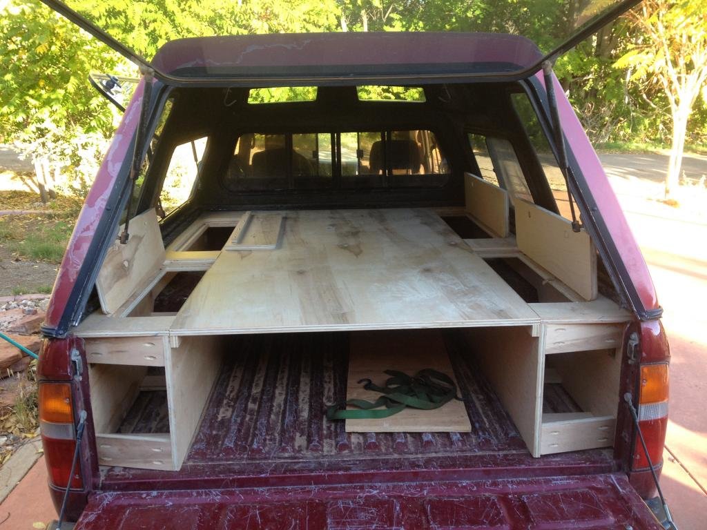

    Pics of platform? Thinking of redoing mine.

    This photo is just after I finished the construction. Since then I cut the center piece of plywood in half short ways so I can remove half the bed for access, hauling tall stuff, etc. I have also sealed with whole thing with marine grade varnish, and added a little closed-cell foam for padding on top. 4 Pieces, comes out or goes in in less than 5 min. But honestly, I usually just drop the two center pieces down and keep it all in there. The 3/4" maple plywood looks good, and holds two people on the 30+ inch span no problem.
    If you want current pics let me know.

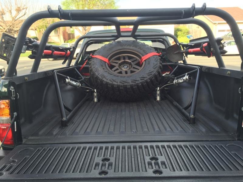

    Installed some things.

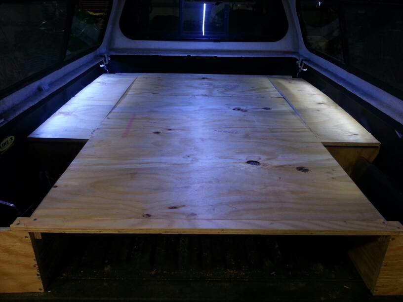

    Looks fairly similar to mine, but your craftsmanship is way better! I have had 2 people and an 80lb pit in mine. It was a little cramped but not bad.

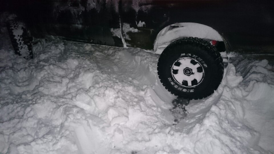

    got stuck.. Time for a front lockerPART_1423951458083_mms_img1743464488_zps_3e78acd990ef5e509f1ff849501cf9083fb0ce31.jpg

    or better tires:)

    airing down got me out! on an icy slope. I was thinking about studding these tires for the winter. probably should have... Love them for everything else.
