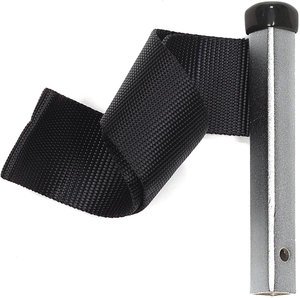

  1. Feb 17, 2015 at 6:11 PM
    johnboyTRD
    johnboyTRD Well-Known Member
    Sep 19, 2013
    #112818
    3,226
    John
    South SF bay
    2003 Tacoma Double Cab TRD
    Full ome lift, nitro charger sports all 4 corners (rear shocks relocated), Dakar pack w/ AAL, 882 coils, diff drop, toytec 1" shackles, trail gear low profile front bumper, Tuff Stuff winch, bamf sliders, RAT skids, BAMF Bed Rack, Tepui Kukenam RTT, RAT rear bumper,
    You shoulda taken that pic further away man... Haha just messin man, looks legit.
  2. Feb 17, 2015 at 6:12 PM
    Fernando
    Fernando Hammerdown
    Aug 25, 2012
    #85507
    23,448
    Fernando
    Sacramento
    04 Tacoma DC 4x4
    Too many, See Build
    Lol, I had to get out of the Sun
  3. Feb 17, 2015 at 6:12 PM
    johnboyTRD
    johnboyTRD Well-Known Member
    Sep 19, 2013
    #112818
    3,226
    John
    South SF bay
    2003 Tacoma Double Cab TRD
    Full ome lift, nitro charger sports all 4 corners (rear shocks relocated), Dakar pack w/ AAL, 882 coils, diff drop, toytec 1" shackles, trail gear low profile front bumper, Tuff Stuff winch, bamf sliders, RAT skids, BAMF Bed Rack, Tepui Kukenam RTT, RAT rear bumper,
    I figured something like that. At least you have sun... Never came out here today.
  4. Feb 17, 2015 at 6:17 PM
    RAT PRODUCTS
    RAT PRODUCTS Well-Known Member
    Apr 12, 2010
    #35140
    13,727
    Farmington, MN
    Cummins Coal Roller
    Smokin with a smarty.
    Stab a screwdriver in the bottom of the filter and it drains pretty well. Then loosen it with the screwdriver. Easy and no more oil than a towel can handle.
  5. Feb 17, 2015 at 6:18 PM
    Squeaky Penguin
    Squeaky Penguin Nothing Ventured, Nothing Gained
    Apr 5, 2012
    #76340
    10,096
    Brett
    Steamboat Springs, Colorado
    '01 4WD, SR5, TRD & '13 TRDOR AC
    Lots of dust and custom dents, Check Build
    Don't think it's dangerous at all.
    They were AAE/Safari racks, and I had problems too. BoxRocket had an ITRE failure, Pliny had incorrectly installed ITREs and play in the ITRE, and I had this:
    https://www.youtube.com/watch?v=_HGvYDl716Q
  6. Feb 17, 2015 at 6:26 PM
    PcBuilder14
    PcBuilder14 Well-Known Member
    Jun 19, 2011
    #58522
    23,312
    Brent
    Nor Cal
    2018 Tacoma TRD Off Road 4x4
    The issue isn't me getting to it. Mine is sitting on a lift when I change my oil so I have more than enough room.
    It's the fact that the filter wrench doesn't cooperate to allow me to loosen it only from the wheel well.
  7. Feb 17, 2015 at 6:27 PM
    Deathbysnusnu
    Deathbysnusnu Work is just a daily detour to happy hour.
    Oct 4, 2013
    #113825
    17,342
    Brett
    Fort Crawlins, CO
    Vintage Tundra
    Dog, camper.
    I use a strap wrench like this, going through the fender.
    Last edited: Feb 17, 2015
  8. Feb 17, 2015 at 6:34 PM
    BYJOSHCOOK
    BYJOSHCOOK Mr. Mojo Risin
    Jun 9, 2013
    #105887
    27,936
    Josh
    Woodstock and Alpharetta Ga
    2000 SR5 4WD Lunar Mist
    Check Out My Builds
    I never have to use the wrench, I just hand tighten and I'm good to go. The guys a jiffy lube or wherever you go tighten those things down too damn much :eek:
  9. Feb 17, 2015 at 6:35 PM
    PcBuilder14
    PcBuilder14 Well-Known Member
    Jun 19, 2011
    #58522
    23,312
    Brent
    Nor Cal
    2018 Tacoma TRD Off Road 4x4
    Hand tighten it myself every time. Never loosens by hand 6,000 miles later.
  10. Feb 17, 2015 at 6:56 PM
    presto
    presto Well-Known Member
    May 9, 2011
    #56375
    2,243
    Topher
    san francisco
    2000 T4R 4x4
    Fully armored on 33’s
    Phew.. Thanks man, what a relief. I was just about to order one tmrw but will probably hold off for a while now.
  11. Feb 17, 2015 at 6:59 PM
    tomtom
    tomtom Well-Known Member
    Jul 15, 2012
    #82706
    5,371
    The Desert SW
    2012 FJ
    I just use the wrench to loosen it then take it off by hand. Try to get it turned over quick as possible. Don't get too much oil coming out. One of these days I'll remember to throw a plastic bag over it before hand.
  12. Feb 17, 2015 at 7:02 PM
    Squeaky Penguin
    Squeaky Penguin Nothing Ventured, Nothing Gained
    Apr 5, 2012
    #76340
    10,096
    Brett
    Steamboat Springs, Colorado
    '01 4WD, SR5, TRD & '13 TRDOR AC
    Lots of dust and custom dents, Check Build
    Like I said the Rack Doctor unit has been trouble free. Others have had good results, but some others haven't.
    Really, the consensus I gather on steering racks is:
    -Buy OEM if you have the cash
    -Rebuild the OEM if you have the time and ability
    -Gamble on a rebuilt unit
    I don't think there is a option for quality new aftermarket racks. I lost out on my time, an alignment, and return shipping replacing what is considered the best option in new aftermarket racks.
    Last edited: Feb 17, 2015
  13. Feb 17, 2015 at 7:03 PM
    devinzz1
    devinzz1 Well-Known Member
    Jun 28, 2014
    #132892
    7,107
    devin
    lewisporte Newfoundland
    2023 aclb trd or mt
    icon stage 10 kit, toytec 1" bl, 35" general x3s, 17x9.5 procomp wheels, locker anytime mod, s&b intake, blackhawk 2.1 tune,
    Same. I just turn wheel to left. pop out liner clips and change the filter. No drama. I dont care about the spilt oil though.
  14. Feb 17, 2015 at 7:13 PM
    presto
    presto Well-Known Member
    May 9, 2011
    #56375
    2,243
    Topher
    san francisco
    2000 T4R 4x4
    Fully armored on 33’s
    Hmm just checked camelback toyota and it looks like an OEM power rack for 4wd is around 550$ vs about 400$ from rack dr plus you get a 100$ core deposit back(minus shipping..) Guess I'll see what happens, thanks for all the input it was really helpful.
    Edit: I think maybe I'm looking at the wrong thing on camelback toyota, sometimes those diagrams are kind of hard to figure out, I'll probably have to call to get a price.
    Last edited: Feb 17, 2015
  15. Feb 17, 2015 at 7:38 PM
    Squeaky Penguin
    Squeaky Penguin Nothing Ventured, Nothing Gained
    Apr 5, 2012
    #76340
    10,096
    Brett
    Steamboat Springs, Colorado
    '01 4WD, SR5, TRD & '13 TRDOR AC
    Lots of dust and custom dents, Check Build
    Rack Doctor was like $250 plus $100 core and return shipping of the core. I though I remember OEM being between $800 & $900. :notsure:
  16. Feb 17, 2015 at 7:41 PM
    lotsoftoys
    lotsoftoys pavement is boring....
    Apr 22, 2010
    #35790
    7,299
    Jace
    Denver
    98 lifted panda taco
    bunch of crap
    different years take different racks believe it or not.... i was pissed when i found out my price on my oem was 800. and a different year was 500.
  17. Feb 17, 2015 at 8:53 PM
    Blackdawg
    Blackdawg Dr. Frankenstein
    Dec 31, 2010
    #48500
    81,649
    Monte
    Wyoming/St. Louis
    The Trifecta of Taco's
    Seriously?? Cause...I've had two different 4 runner racks and they are the same..and I have another spare taco rack and it's the same..what's different?
  18. Feb 17, 2015 at 9:30 PM
    Adventurer_Alex
    Adventurer_Alex Generic mall crawler
    Oct 8, 2012
    #88584
    7,281
    Alex
    AZ
    2013 Nissan XTERRA
  19. Feb 17, 2015 at 9:52 PM
    ThunderOne
    ThunderOne Well-Known Member
    May 20, 2009
    #17473
    10,048
    Mitchell
    Nashville
    1ST GEN OR GTFO
    Toyota NERD
  20. Feb 17, 2015 at 9:59 PM
    LogCabins
    LogCabins Well-Known Member
    Apr 30, 2014
    #128878
    2,310
    Robert
    Oahu
    99 SR5 3.4L 4WD
    Love the color!!!
