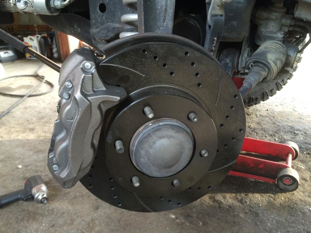

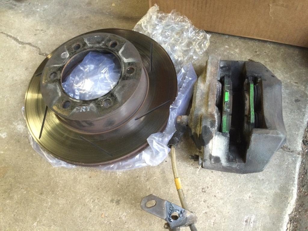

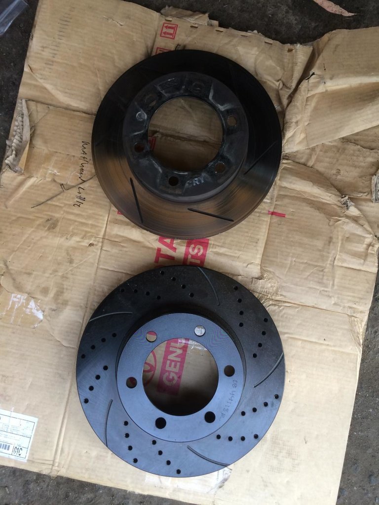

    Yes, the center vanes. See my edit above with picture.
    I raced track for many years before I got tired of staying in between the lines and bought the truck. Very familiar with brake upgrades and directional rotors.

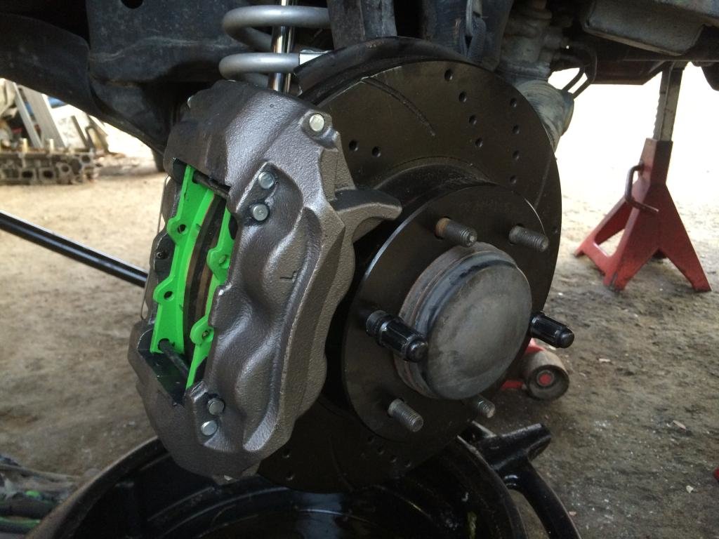

    I didnt drive the truck to work today so its only got like maybe an hour of driving on the kit.
    on a side note the last discount tire I had rotate and rebalance my wheels and tires destroyed a lug nut and almost couldn't get it off the truck, in the process it chewed up a spline tool.

    Got of the phone LCE, they said they can be run either way but list it as directional to make it easier for people.
    They told me people run it both ways with zero issues.

    The kit is designed to be a direct bolt on out of the box, if you piece it together it may be around the same cost or less but you may need to modify brake lines unless you buy the kit that is somewhat universal from wheelers, it will not mount the same however.
    This kit uses hard lines off the caliper and wheelers uses a modified line instead.
    I ordered a custom kit without the brake pads provided as I do not like Hawk LTS pads and went with EBC instead.
