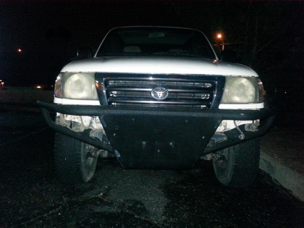

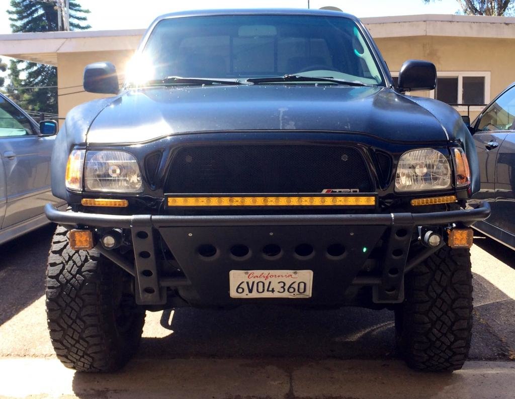

    New (to me) bumper! Ignore the super ghetto, temporary turn signals and my awful photography skills. :D

    nice bro^, i did the exact same thing with my turn signals till i got the trail gear led kit haha. but in hindsight i probably would have just done the blinker relocate mod and stuffed em in the side lights.

    That is a cool mod but I want to do something different, make it a little unique

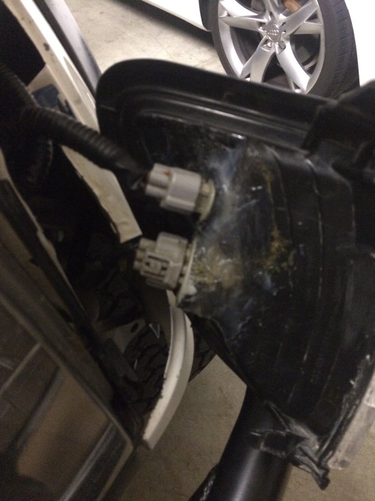

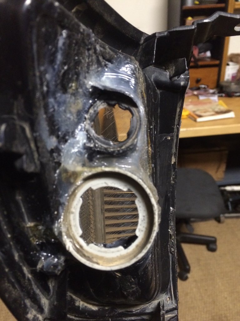

    Nice. Here for an idea this is what I did
    c2886a19023d7cc27d0e8fe8057dbbde_11b61abfc3b103634820a59dbfc1214f12365562.jpg1ec8c76adfdff35d03c970e1a6a8526d_0c084cd253c1d9b7f7aea79c2f67d6542f565e83.jpg
    I moved the marker light up and put the blinker in the center slot, cut, fit, glue, seal and done!

    I saw a write-up how somebody did that, does look good. Hmmm

    Yea I've done a write up and Brent has. It's easy to do. Works well.
    Or rewire the marker lights as blinkers.

    I used Morimoto XB LED strips in Amber, they are just the right length to slide inside the side markers.

    Was just thinking of something and thought I'd ask to see if someone knows. I have 2 led pods to put somewhere and I want them where the turn signals are in the factory bumper. Can I remove them and wire my corner lights as the blinkers? Then take my corner light wire and run it to the pods? If that makes sense to anyone

    Yes. Not sure what your laws are, but you will likely still need to have Amber corner lights(running lights)

    Okay cool may try the corner and turn in the corner housing like the one above

    Mine has both the running lights and 1/2 turn signals in the corner housing that fire out to the side in addition to the led ambers that fire forward under the headlight.
    So the top light in the housing is the smaller bulb in led form that has a nice amber glow when the lights are on.
    The lower section of the corner lights is a bright amber halogen bulb that was added using parts from the old turn signals, the ones under the headlights are a lighter amber color but are very visible in day and night.

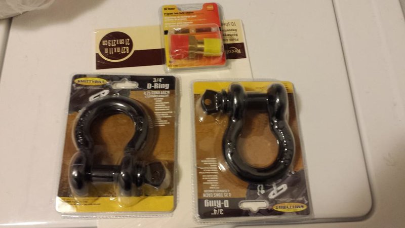

    D-rings arrived today
