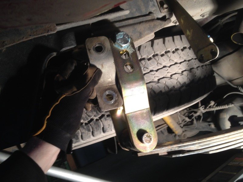

    Yes they are the toytec adjustable. However I decided to go down to the 1" holes, which required cutting off the 2" holes (dumb design). I cut them too close (dumb human) and now I can't safely use the 1.5" setting. But it's no big deal I sit somewhere between .5" and .75" higher in the back even with the extra weight.

    Waiiiit huh? You can't use the 1" setting?

    No it hits the mount or something. I tried :)

    That's so dumb. Good to know for when I eventually upgrade my springs!

    Yeah most definitely.

    I have the Toytec adjustable shackles. I have them set on the 1" lift and they don't hit anything. From the looks of your picture it looks like the bumper mount is in the way. Nothing a quick hit with a angle grinder wouldn't fix.

    Yeah I thought you just had to grind down the bumper mount when using the short holes, not cut the actual shackle.

    There ya go. To my credit (excuse inbound) I wasn't too savvy with the grinder back then. Still not... Haha
