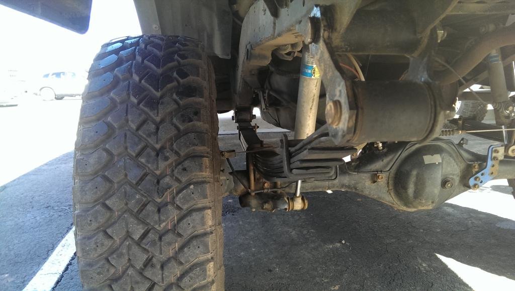

    Lots of dust and custom dents, Check Build
    Mated my Wheelers 6 packs with a set of Chevy leaves off a '91 S-10. Ended up with 3 Alcan leaves, and three Chevy leaves. Netted 1.5"ish more lift, while ditching some 2" lift shackles in favor of the stock shackles.

    Brett, you do all the that damn work, make a cool leaf pack, but u dont mount up a u bolt flip???????? Duuuuuuuuddddeeeeeeeeee

    U bolt flip and shock relocation is in the works, aren't you reading my build? :p

    Yes but i figured u wouldve installed at the same time. I drove aorund with out shocks for a few days lol

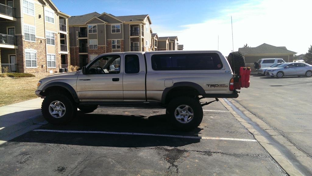

    Gave it a bath for once.
