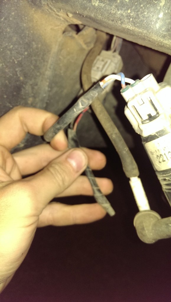

    I just pulled the pins out of the connector, but yeah the sensor is useless.

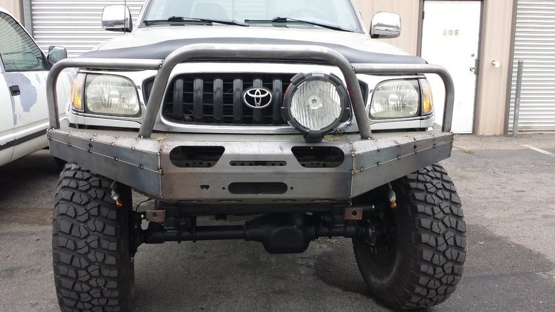

    Front guard is in progress forming
    as a bumper little by little. Sweeeeeeet:burnrubber:

    Thanks!
    Thanks! I designed the whole thing around the light bar being in that position.
    Thank you! Well I started it Feb 27th and worked on it here and there after work. I'd guess I'd have somewhere around 24hrs invested in it. If I knew what I was doing in sure it would have been quicker. The whole thing was a learning experience.

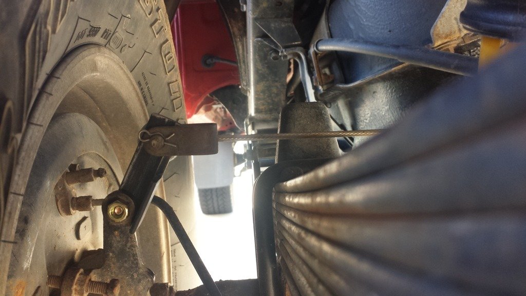

    Made some E-brake extension brackets to get my cable off the leaf pack.20150214_154041_zpsx7pbgiac_4d0bb4618cddd625934440f526f514215c4a3a42.jpg

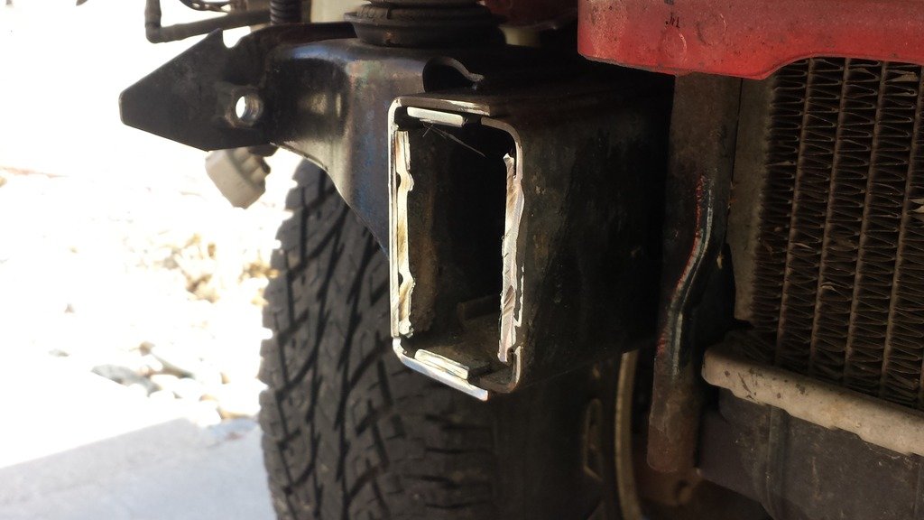

    Cut off the old frame caps, welded in some new 3/16 iron and painted it up. No pics of the finished product. Not much to see, just some plates welded to the end with a nut tacked on back. First time fabricating anything for this truck.

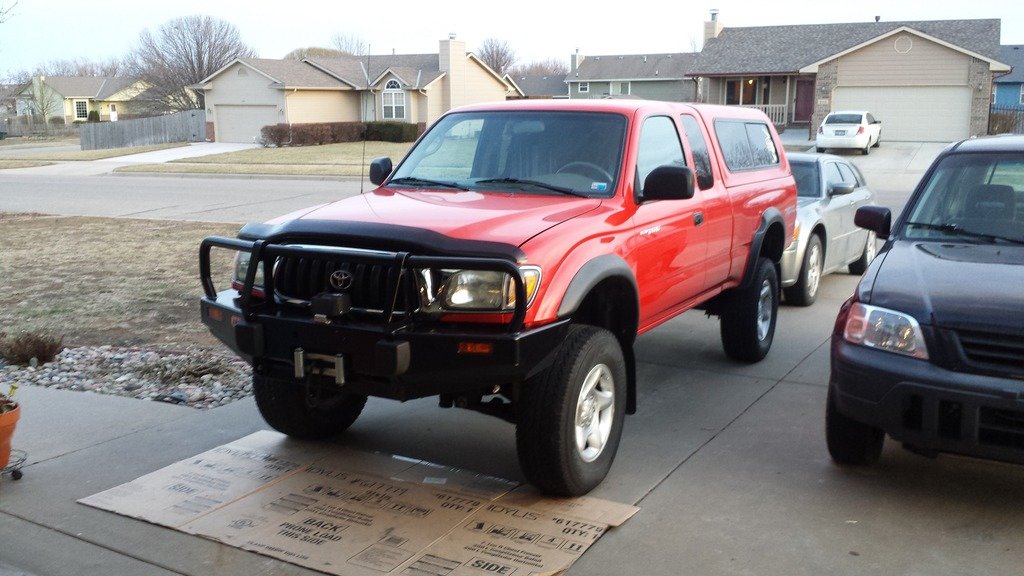

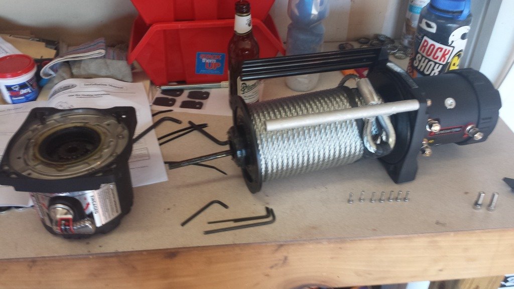

    20150307_142322_zpspa0etej1_61766aa4cfb687367cf4e1e9af00fcc42a302f43.jpgOnce that was done, I stuck the new ARB bumper on. I put a Smittybuilt Gen 2 XRC 9500lb winch in and reclocked the motor and clutch for a better position to wire up and to reach the clutch handle. 20150306_160121_zpsiwd13vuw_7f5b1eea93d627810e7bbd5dd52159550e7873c5.jpg20150307_182030_zpsgzforljo_3e5b0a99e48b209339ec5f17ccacfed605350e2b.jpg
