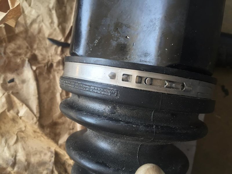

    image.jpgFor those that have changed cv boots before, were you guys able to get the inner ring clamp on all the way to the last hook? I was only able to get it to the second hook and am scared it may come off.

    where are you guys buying those clamps?? I need the small ones. I'm assuming I need a special tool for them too?

    I bought the whole inner boot kit and it came with both clamps. For the small inner one I used end cutters. I was able to just force them closed with a needle nose then used the end clippers to tighten the clamp. The larger inner boot clamp was as easy. I'm hoping its good and will stay on. But only time will tell.
