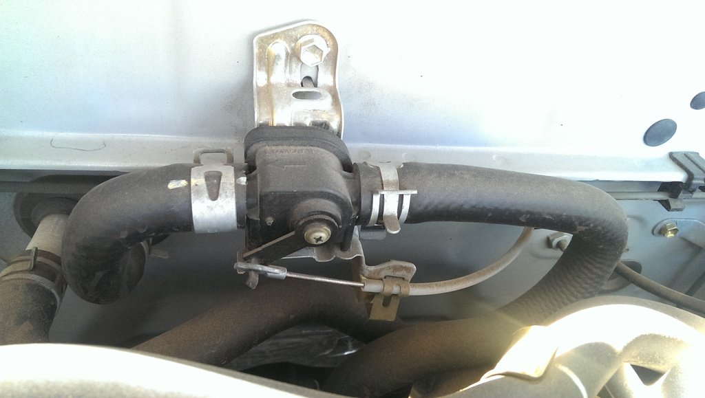

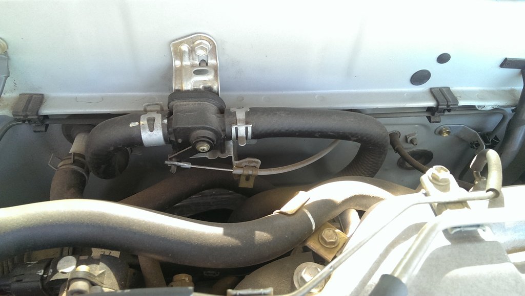

  1. Mar 22, 2015 at 2:56 PM
    Delta00

    Im posting anyways...

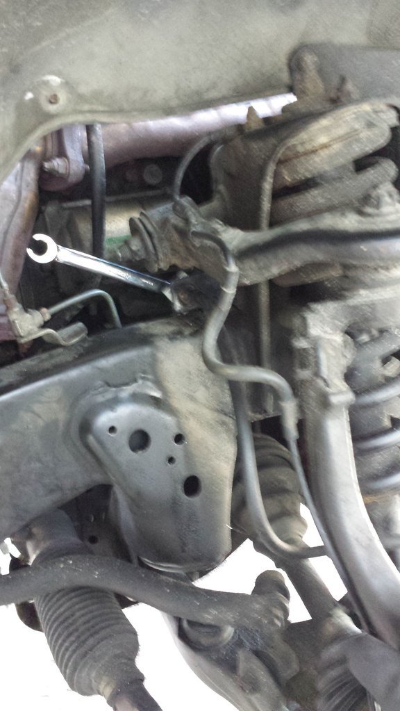

    How the hell do I separate the rubber line from the hard line? Whether I pull the c clip or not the whole thing swivels around when I try to rotate it off. After 2 trips to the parts store, broken sockets, and hours in the cold I kinda ran out of patience and time.

    Thanks, looks like mine but cleaner :) you da man.

    Ha only 80000 miles will do that.
    And i dont offroad to often haha :anonymous:

    You don't have me beat by much, @ 92k :)

    Leave the clip in
    Then get some small vise grips for the soft line to help hold it.

    Don't pump the pedal a bunch of times, just once to the floor and get something to hold it there. Initially there will be little fluid that leaks out. Just don't open the line all the way at first. I'm not very good at explaining the science behind it but I assure you it works. I've been using that method on an almost daily bases for the past 7 years. I also use a brake pedal depressor off of the alignment machine, which most people don't have access to.
    If you leave a line open it will drain the MC and you'll have a lot more air in the system to purge. Plug the hard line or use the brake pedal method.

    I was trying to do that with an adjustable wrench before. Then after it kept slipping I got red in the face.
    Ill try the vice grips when I go back to it. Good idea. Thanks.

    Best advice! Small vice grips world of difference
