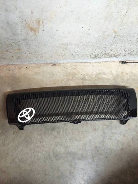

  12. Mar 26, 2015 at 1:06 AM
    neegdogdig
    neegdogdig Untrained with bad experiences go go go!
    Mar 18, 2012
    #75151
    1,915
    3rd Gen DC V6
    A damn good net grill for catching suicide bugs
    That thing is too damn sexy for the taco i want 1

  14. Mar 26, 2015 at 4:39 AM
    TacomTyler
    TacomTyler Well-Known Member
    Dec 29, 2014
    #145177
    680
    Tyler
    Georgia
    2000 sr5 tacoma
    They look good on the 01-04 too I could make that one as well

  16. Mar 26, 2015 at 6:08 AM
    lotsoftoys
    lotsoftoys pavement is boring....
    Apr 22, 2010
    #35790
    7,299
    Jace
    Denver
    98 lifted panda taco
    bunch of crap
    that's awesome. I want....
    hell yes, that's gonna be one pissed off lawn mower:cool:
  17. Mar 26, 2015 at 6:15 AM
    TacomTyler
    Dec 29, 2014
    #145177
    680
    Tyler
    Georgia
    2000 sr5 tacoma
    Got the grill installed this morning also took the running boards off, about to take the spacers off

  19. Mar 26, 2015 at 7:11 AM
    BYJOSHCOOK
    BYJOSHCOOK Mr. Mojo Risin
    Jun 9, 2013
    #105887
    27,927
    Josh
    Woodstock and Alpharetta Ga
    2000 SR5 4WD Lunar Mist
    Check Out My Builds
    looks better, now retrofit and paint that chrome!
    What spacers you got and size?
