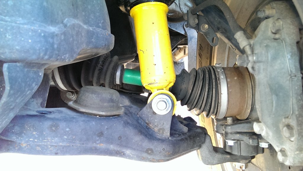

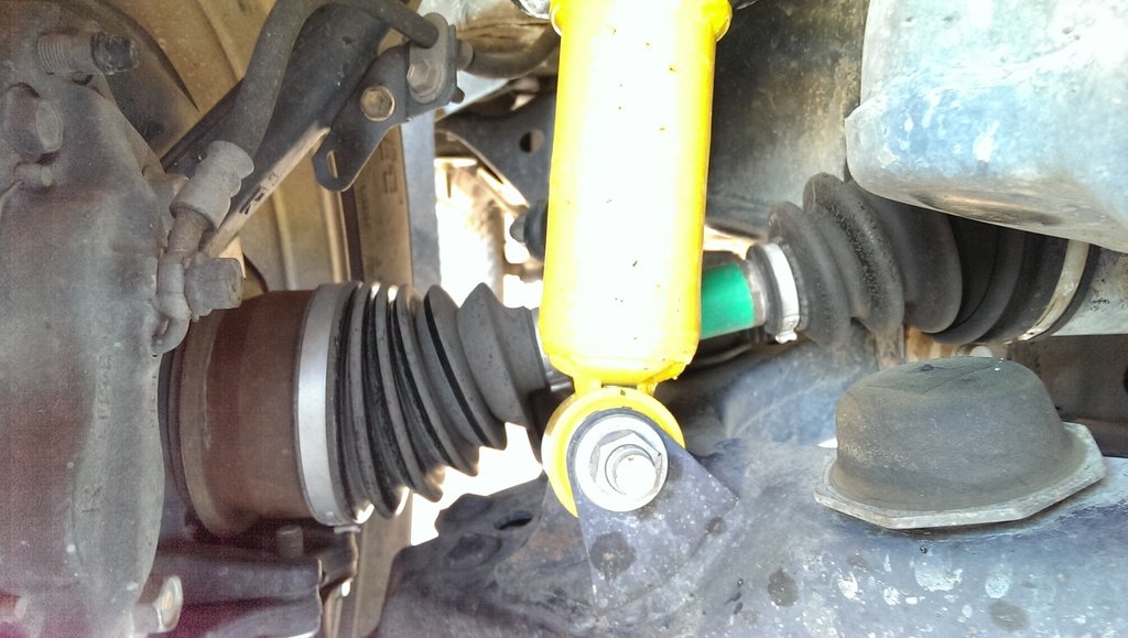

    So you have 882s with a drop kit?
  3. Mar 27, 2015 at 5:50 PM
    Delta00
    Delta00 ᕕ( ᐛ )ᕗ
    Sep 16, 2013
    #112633
    4,137
    Troy
    Chandler AZ
    2002 Toyota Tacoma 4WD
    Check Build
    883 with diff drop
  4. Mar 27, 2015 at 5:51 PM
    TuckGraham
    TuckGraham Keep it straight
    Nov 30, 2013
    #117625
    627
    Tg
    Montana
    To me it looks a little less of an angle. But nothing really to stress about

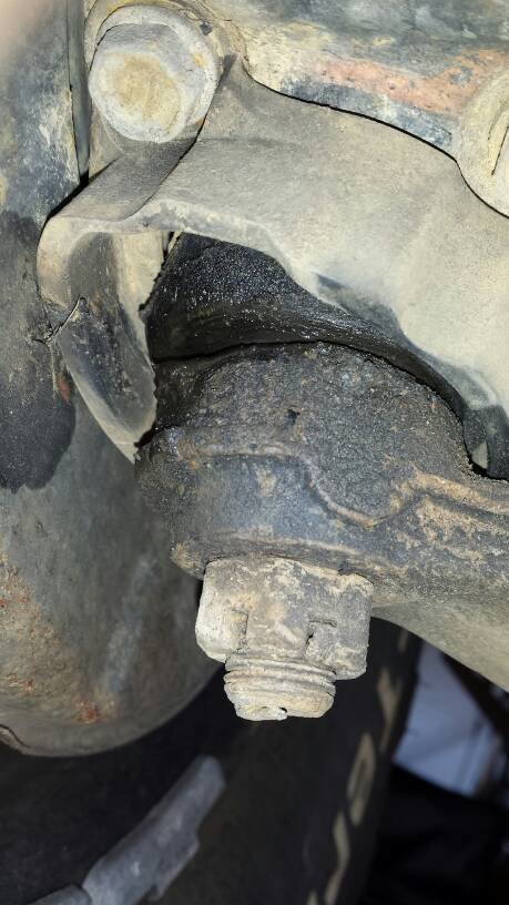

  10. Mar 27, 2015 at 8:38 PM
    95 taco
    95 taco Battle Born
    May 3, 2012
    #78175
    17,537
    2003 4x4 TRD SR5 auto
    OME 883 front, OMD 3.5" rear, Relentless front bumper, smittybilt 9.5K winch
    Camelback has OEM for $55 (drivers side) and $60 (Passenger side).
    I want to replace the LBJ bolts when I replace the BJ's, where is the best place to get them? I didn't see them on camelbacks site.

  13. Mar 27, 2015 at 10:55 PM
    Blackdawg
    Blackdawg Dr. Frankenstein
    Dec 31, 2010
    #48500
    81,652
    Monte
    Wyoming/St. Louis
    The Trifecta of Taco's
    :anonymous:
    Good call ha
    OEM all day over the Moog
    Pitman puller is all you need that's different. Way better then a pickle fork. Can rent one for free from the parts store. Or just buy it. Like 15 bucks

    Diff drops don't even lower the diff. They only lower the front mounts so the net drop is like less then 1/2".
    All the photos in here have the same issue and that's the fins on the boots are touching. You can see the wear on them as they are dark and shiney. Eventually. The boosts will eat through themselves.
    This is where aftermarket cvs have the only advantage as their boots have less fins which means a bigger gap between them and that means they don't touch. Sadly, the replacement cv axles themselves are weaker. So when you blow a boot. Try and use boots with less fins.

    Don't they make high angle CV boots?
  16. Mar 27, 2015 at 11:48 PM
    Balockay
    Balockay Well-Known Member
    Dec 19, 2014
    #144595
    4,167
    Blake
    Cleburne, TX
    2017 4Runner TRD ORP
    Just look at the build thread
    Yes.

    This. Pitman puller s cheap and perfect for popping OTRE's and LBJ's. Love mine.

    My buddy got those when he got coilovers because he kept ripping boots and he payed a little over 100 for them but hasn't had a problem since
