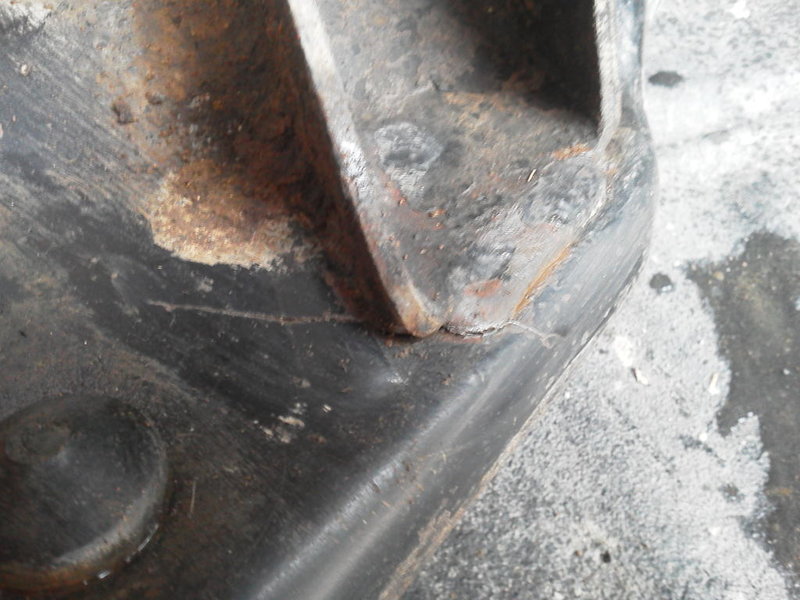

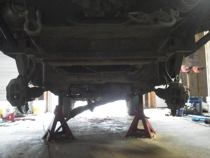

    Replacing my control arms because I cracked them.

    How'd you manage to do that?:confused:

    X2....need pics and a story

    Well...not entirely sure. I blew up the sphericals in the rod ends on my camburgs and I think the extra slop that created let the coilovers slam up and down just enough to crack the arm right there. Other LCA has the exact same crack and I blew up the spherical on that side too, so the slop + all the sustained abuse probably did it.

    so the shock mounts on the LCA's are cracked? Why not weld the cracks? Or are they too far gone?
