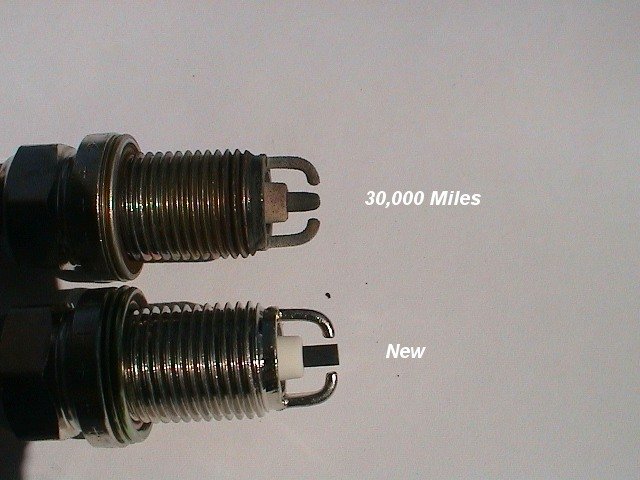

    Mine was doing some weird bogging, lunging, and jerking. I was seriously afraid it was a tranny issue even though it was a misfire based on the error code.
    It turned out to be the spark plugs. I forgot to take a picture of the plugs but the wear was basically an exaggeration of the image below. New plugs. No more problems.

    Yeah. You just described my 2 month thought process. I would check the spark plugs.
