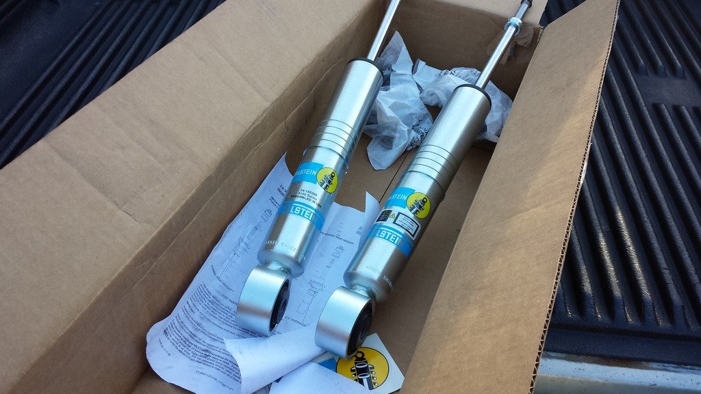

    Shocks and B-stock retrofit parts came in this week. Did quick mock up to see what I'd look like. Hopefully shock install goes smooth this week.
    More pictures in build thread.

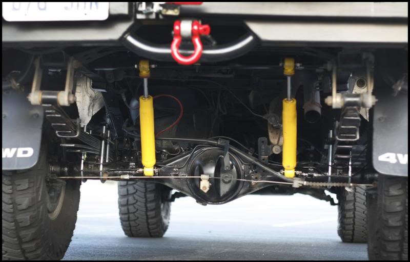

    I learned my lesson on shackles the hard way. Way more detrimental aspects to longer shackles than they're worth. They'd be just fine with longer springs, but for all the off-the-shelf options, stock shackles provide the best performance IMO. None of these springs change in length enough to ever use the range of motion of the shackles anyways.
    Modified my leaf pack to suit my lift needs, perfect shackle angle with stock shackles:
    Didn't really loose any droop either, same poser rock:
    2" lift shackles:
    New setup with stock shackles.
    Look at the shackle angles, gained uptravel too. Need my can of worms smiley.
