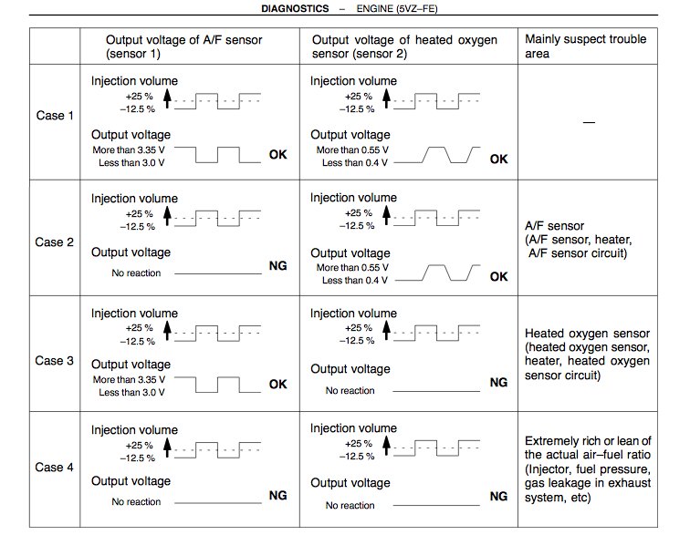

    So I had them backward. THe UG does show bank 1 and 2, I just didn't see it. So the first sensor is actually steady at 1v while the other fluctuates slowly around half a volt or so.
    Which means I'm running way too rich if I'm understanding correctly. Hopefully the cat is still good.
    If I end up replacing it, anyone know the correct part number for the upstream o2 sensor on a 3.4l? Rockauto lists a few different variations.

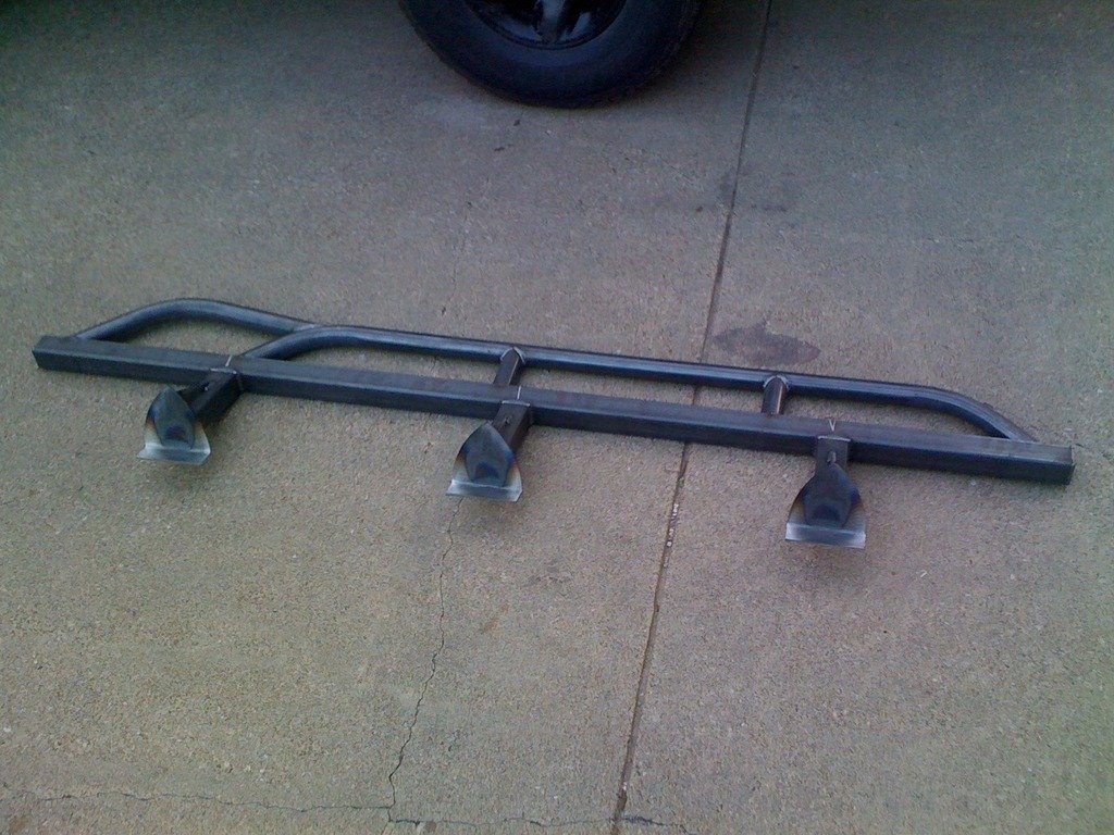

    :woot: These are going to look great!

    It's less Tacoma and more mod
    Who made em? They are gonna look awesome on there!

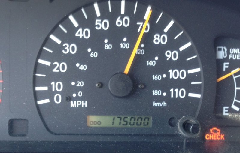

    Hit another milestone today

    Congrats CEL?

    I love looking at my dash and there being not one light on!

    Lucky. My CEL has been on forever. I've already checked it though! It's still in there.

    Ultragauge can tell you why its on and can clear it.
    Or take it to a pep boys
    In Cali you cant pass smog with it on.
