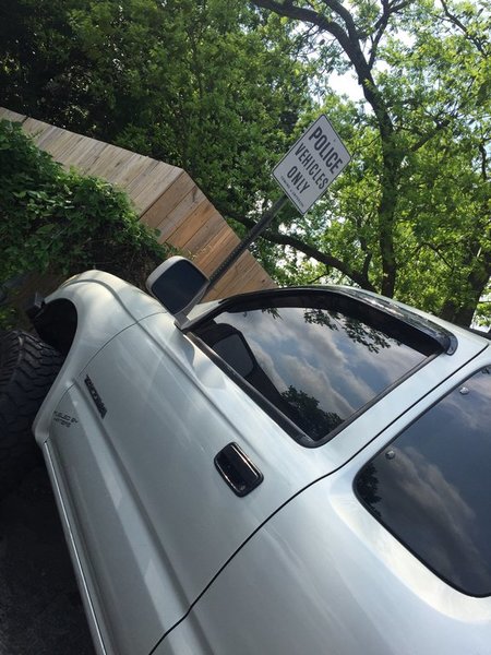

    Parked it in its proper spot

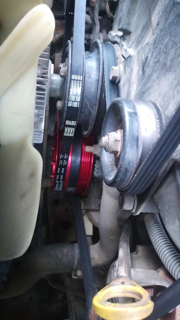

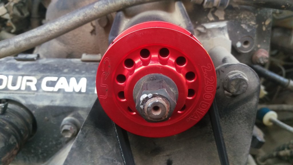

    Here is my new additions, 7th injector kit, 2.2 S/C pulley & light weight SureGrip Crank pulley. (please excuse the filthy engine bay, been doing quite a bit of wheeling lately & haven't gotten a chance to clean it)

    Is that an aluminum crank pulley? I've read up a little bit on those, supposedly the OME crank pulleys have harmonic balancers in them and by installing one without it the life of the engine will be shortened drastically.
    Maybe someone else can chime in, this is just what I read when I was researching the under drive LCE crank pulley.
    However that is the only pulley with the balancer in it and all other pulleys could be changed out I think?

    I don't know about shortened but an aluminum crank pulley might allow the crank to gibrate a bit more than normal. Its meant to allow it to spin up faster similar to light weight flywheel. Pro lem with that is if it's a manual transmission vehicle, lightening the rotating assembly could make it more difficult to get the vehicle moving. It'll stall easier. But in most applications, the vehicle isn't stock so they Rev the bitch up and dump the clutch☺
    My opinion.... the difference a crank pulley makes is probably much smaller than what a lighter flywheel does...
    U went the other direction. I put in a heavier flywheel the stock. Just try to stall my truck lol

    Basically they were saying since it vibrated the crank more it doubled if not tripled the internal wear and tear.
