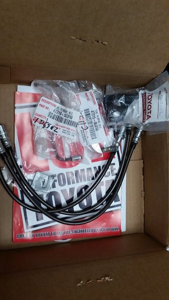

    The calipers come unpainted and will rust within days. Also the Hawk pads they provide are terrible compared to anything by EBC.

    That's what I was afraid of too. Pads and rotors are coming from EBC. Caliper are powder coated from Callahan.

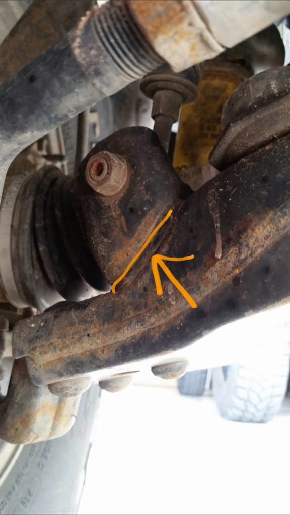

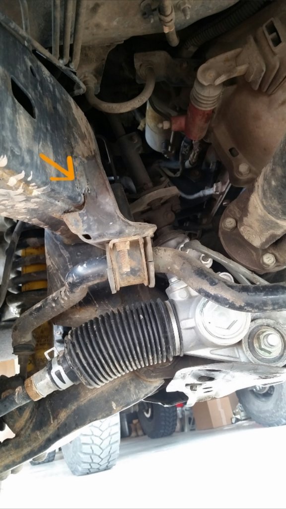

    Hey guys so I'm wanting to cut my sway bar off with my angle grinder just wanna make sure I'm cutting the right things since I'm new to the cutting scene..and I'm also wondering if there's any tension I need to watch out for when cutting it. I'm not even going to bother trying to take it off so I can put it on again I just want it gone haha
    I'm thinking I'll want to cut both those mounts on both sides..?

    Just detach it and call it a day, no reason to cut anything besides inviting rust to take over. And holy shit..... at least detach it before cutting if you are stuck on doing something stupid. If you are parked on a flat surface there isn't any tension but it is still risky and entirely unnecessary. Just be safe and reconsider cutting. Understand I'm not attacking you, I'm attempting to stop you from doing something you may regret. As your suspension softens you might find you want that sway bar back on.

    I cut here with my grinder, truck sitting on all fours. No issues at all. My bolts were seized. No need to grind the bracket on the LCA, just grind the bolt off if you are set on grinding it off.
    but do try to unbolt it using tools first, if they are seized, hack away.

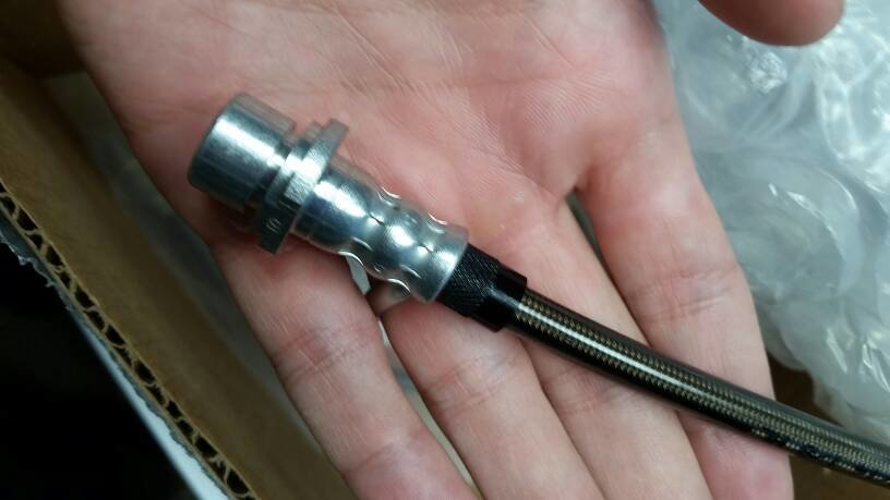

    This LCE kit just includes the hard lines, brackets, clips, and SS hoses. The hoses are very nicely terminated and have a knurled metal collar.

    Just unbolt/remove the sway bar. No need to cut the mounts off unless you're putting something else there.

    I think the dead horse has been beaten but... you can unbolt the sway bar. No need to cut. If the bolt is seized like Ferny's was, just cut/gring the bolt off and then remove the bolt. Easy peasy.

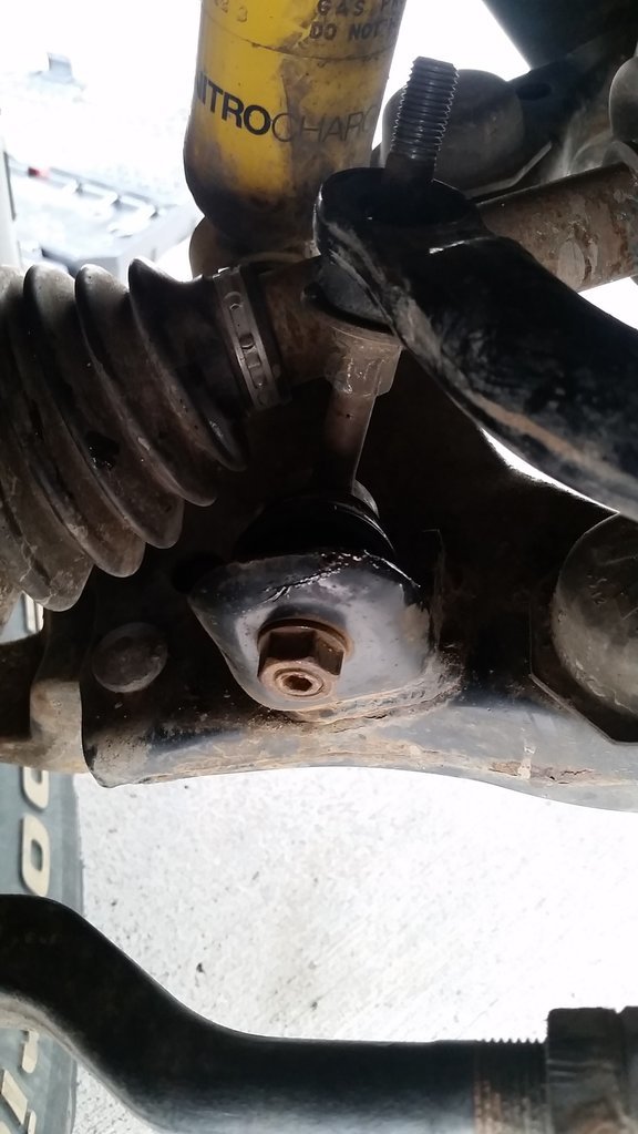

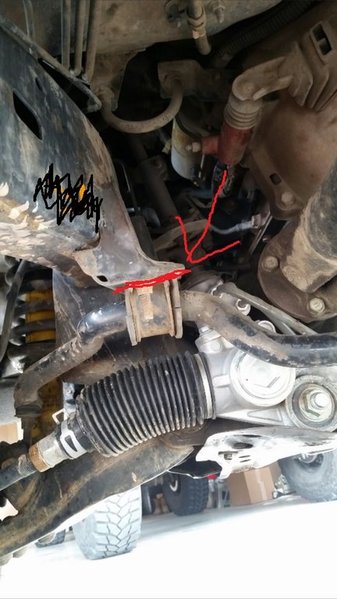

    So how in the hell does this little rod w/ rubber joint thing come out cuz that 17mm bolt just sits there and spins..
