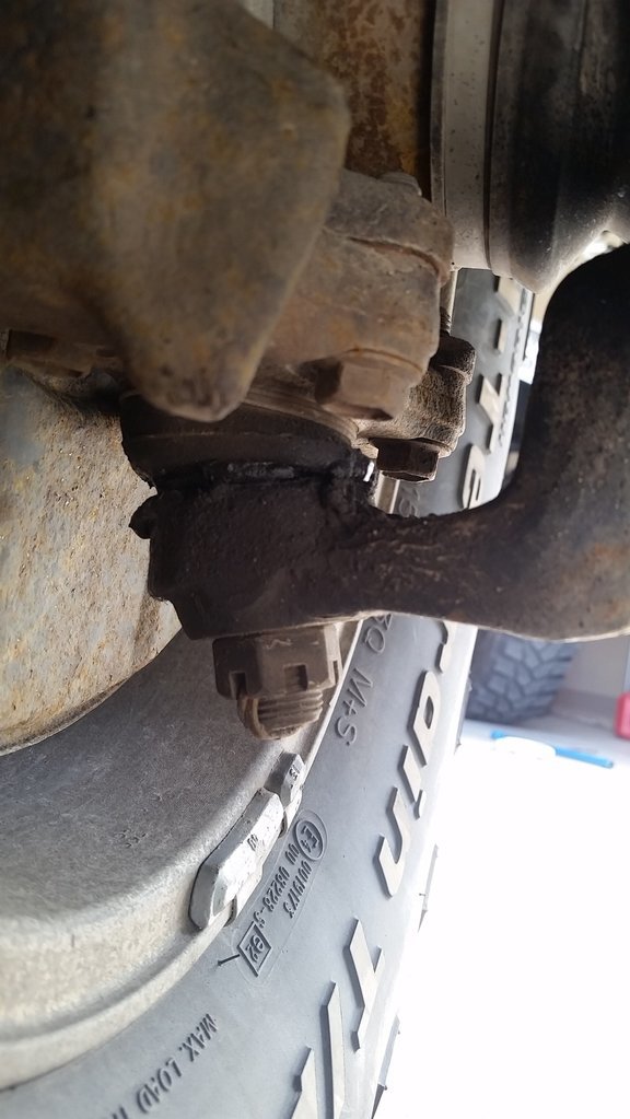

    Why? It looks fine, check it and replace when needed and it shouldn't be any scarier then driving your moms Honda

    It's lookin a bit wet and I don't know how long it's been like that

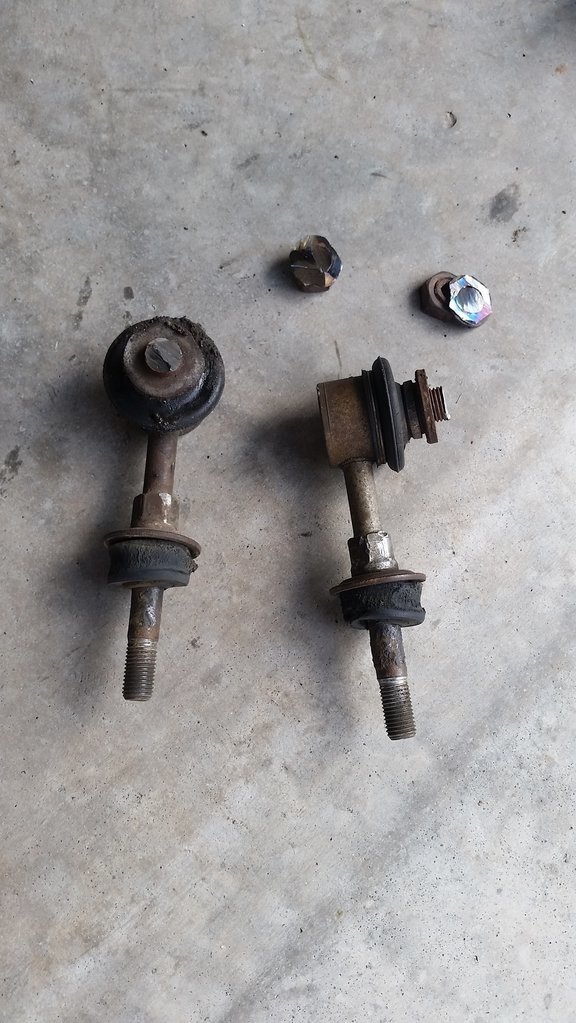

    Got the little bastards off huh? I may remove mine today, kinda wonder if the end links are the parts making clanking noises when I go over bumps. I think I'll cheat and use and impact gun and an impact allen attachment.

    Oh yeah thank god..easy peasy cuttin the bolts. Seems to handle rail road tracks a lot better now. DO IT!!! Haha take em off and you'll find out

    Those LBJ look ok. just road grime no?

    Hard to tell without feeling the buildup. If it is sorta greasy (possible leakage from LBJ) rather than just dry and gritty (just road grime).

    ahh, gotcha. Mine have a bit of grime around them. not enough to make me swap them yet

    They're greasy, or at least the drivers side is. Haven't checked them for play. Might as well replace them both at the same time for peace of mind.

    Check the ball joint for play, once the grease starts leaking out it does become a ticking time bomb, that is why I prefer the Moog's because you can grease them. But to check play put a jack under the arm and lift the tire off the ground, take a long pry bar or something you can put under the tire to try and lift, if there is play in the ball joint replace it. If there is no play then you are ok for now, but with the grease leaking out it wont be ok for long
