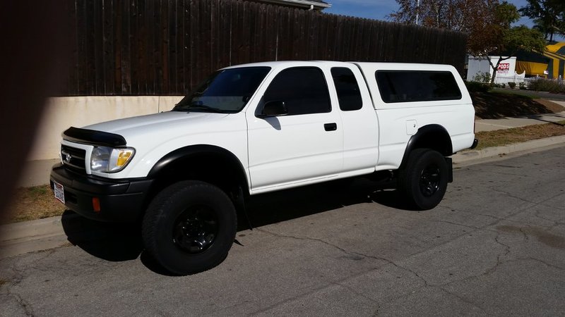

    Started with this '80 back in the mid '80s
    Had a 2000 xtracab 4x4 replaced with this '98 v
    And yes now 2nd gen...

    Wow that 80 is baddd
