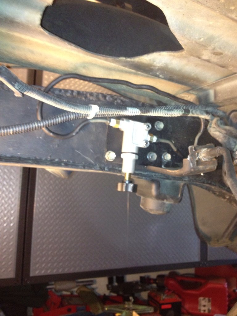

    I use a Wilwood brake proportioning valve. It's good for 100% down to 57% brake bias.
    8E9604D0-6195-491F-A264-4CD804469F41-257_b52e4708035002ce708b39170c489bb839ae084f.jpg
    Drilled rotors shouldn't be used on OE sized disks. Think about it...there are holes in the disk. Holes means less surface area. Less surface area means less pad contact. Less pad contact means shittier stopping power. It's really that simple. If you replace your factory rotors with cross drilled rotors, your braking performance will suffer.
    Race cars with crossdrilled rotors are huge. Literally 17" rotors with 6 piston calipers. Far cry from a Tacoma 12.5" rotor with 4 piston calipers.

    Stupid question but I gotta ask... how are you supposed to tell if the bias is adjusted properly?

    Go on a dirt road. Drive at 20-30mph. Slam on the brakes. Make the rear lock first just before the fronts.

    It's completely subjective. Negro-k9's method is a good place to start. I cut off the bar that runs to the axle from the LSPV and zip tied it as high as it would go and went for a jberry test drive. Slammed on the brakes in the dirt at 70 and only the fronts would lock up while the rears moseyed around like a retarded puppy. Didn't matter what speed I tested, rears never did squat. That's when I knew I didn't have enough bias.
    My personal preference...I like the rear's to lock up just a cunt hair before the fronts do. It allows me to pitch the rear of the truck into a corner with just a slight tail brake. I tuned for my driving style, so YRMV. I probably did 30 test runs adjusting the manual proportioning valve recording with my go-pro before I was satisfied with the results.

    interesting. which wildwood valve to you have?
