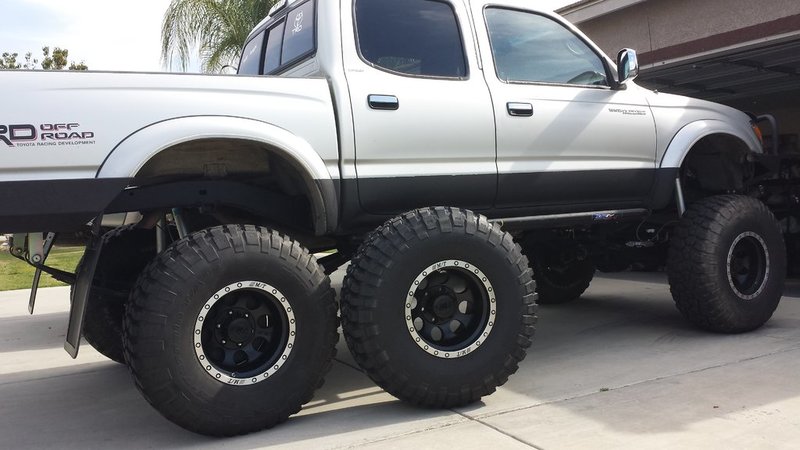

    Was going through photos and forgot about this one...

    Damn I thought that was a 6x6 at first. She's a big fucker :cool:
