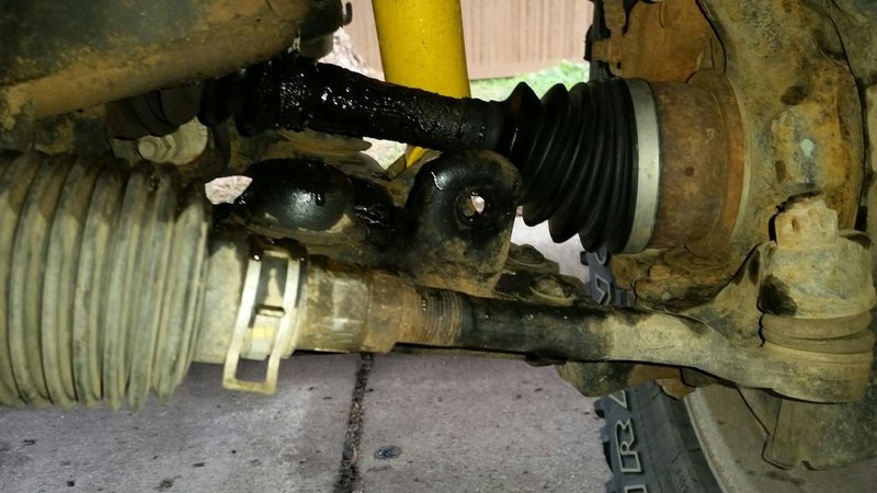

    Boot slide mod is more than just sliding the boot down clamping it. Some people have had luck just doing that, but the boot slide mod has an internal stopper. If you decide to reboot your axle, youll be able to get a better understanding of the boot slide mod.

    Replaced my 4 banger boots 2 yrs ago n they still in good shape got my from Oreiley too. U'll need to save your old one if you are going to use the universal boot from Oreiley cut the end of the old boot and slide under the new boot to be able to put a band over it. Their universal are thiner and more flexibility can't find a good spot to tie the band so you have to cut out your old one and slide under it

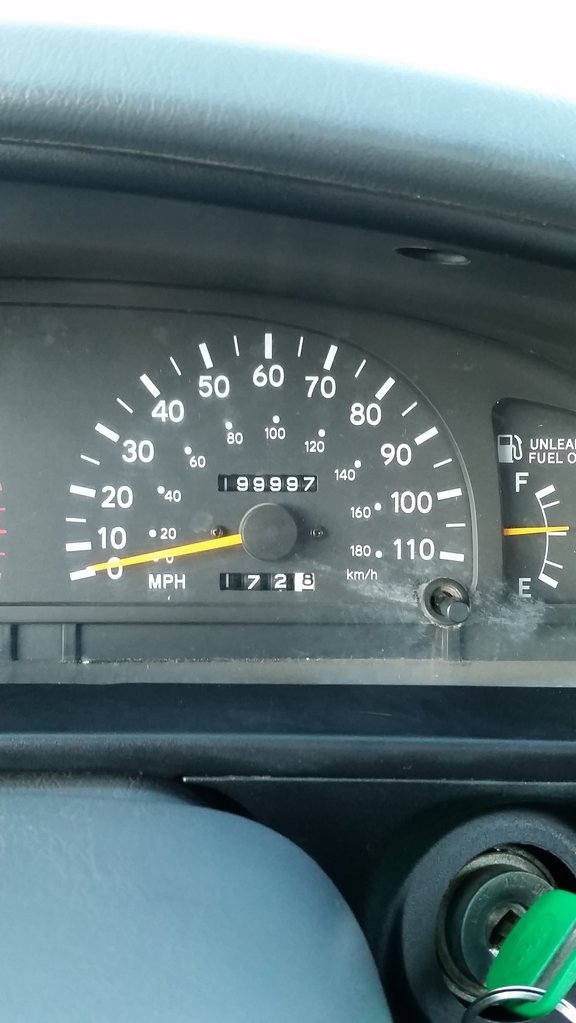

    I drive a 199997 haha

    Is your trip miles for that tank of gas?

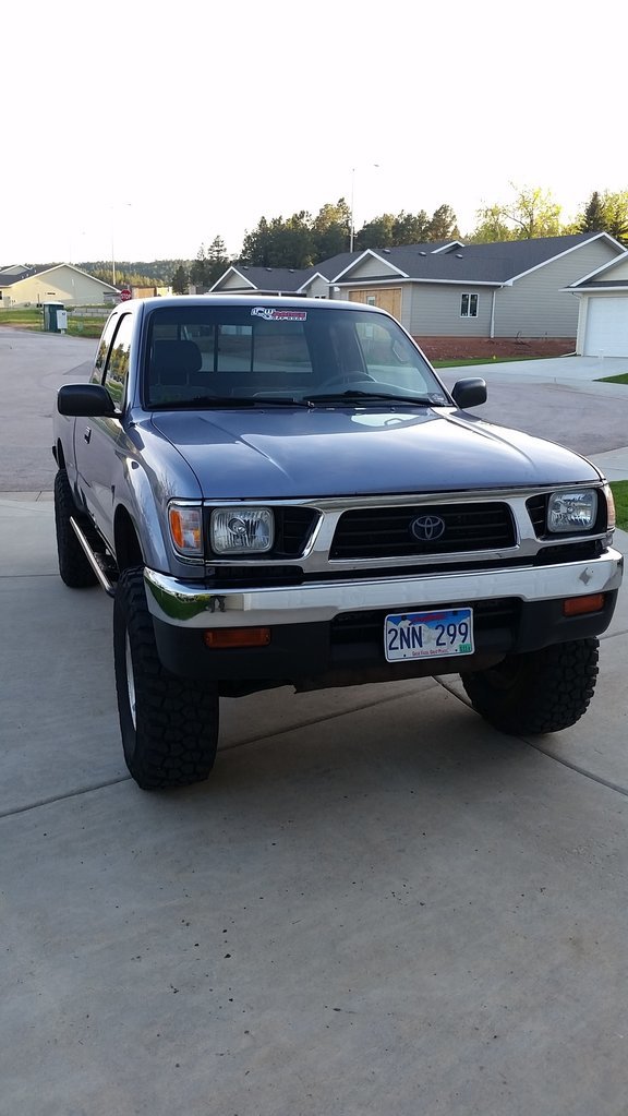

    How the Jumbo Shrimp Taco sits today at 200,000 miles!

    Yep! I got 350! on the last one somehow I've been lucky to get 3 on a tank not sure what happened with the last one but I know my odometer is not super accurate with 32" tires

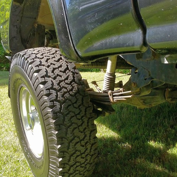

    Tested out my droop, are these 5100s limiting my travel or is that all the springs have?

    Looks like the springs. Pop those boots off the shocks and see if they have any travel left. But if you drive the other side way up that side will drop more.

    I thought about doing that, this tire was off the ground and I could rock the truck. One thing I have noticed is that when on the frame lift, one side of the axle hangs lower. Maybe I need extended travel shocks.

    Mostly likely the 5100s actually. They are only 8.5" long. Any longer though and you loose up travel.
