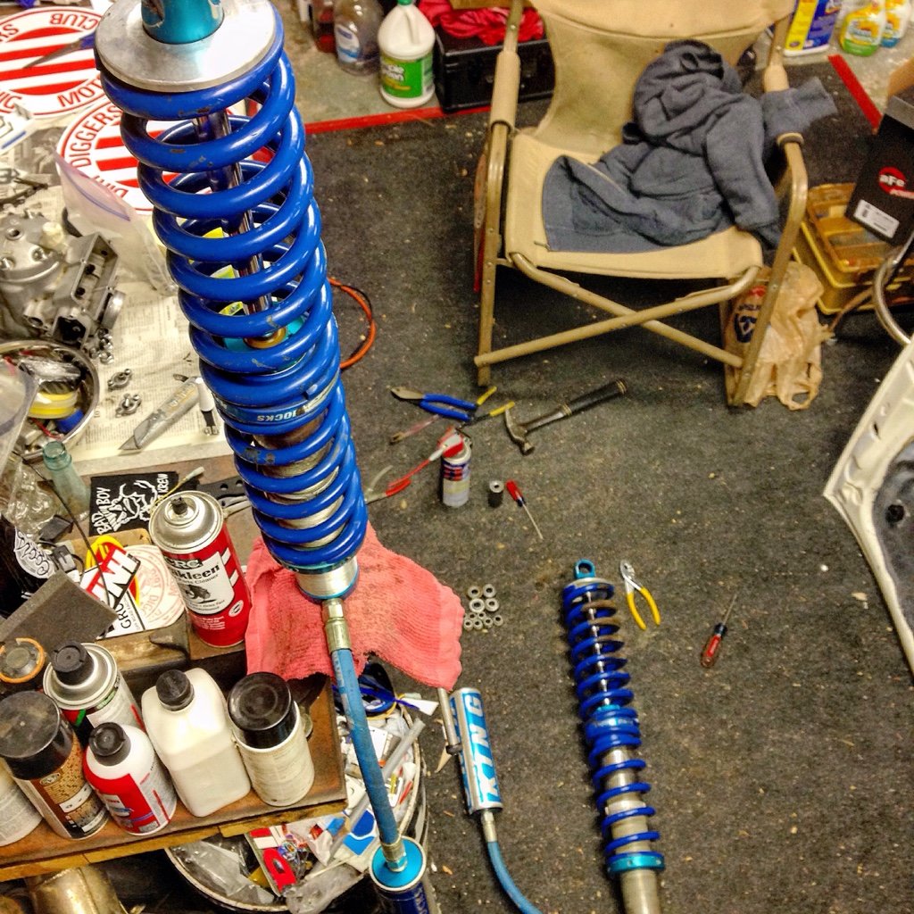

    Currently getting shocks ready for new spherical bearings and wanted to tighten down the top cap a lil cause it was leaking a bit. If it's still leaking I'll replace the o-ring.
    Any pointers on a good way to tighten that top cap for those who have experience rebuilding your shocks?

    Yea, it won't do anything.
    The top cap has nothing to do with holding oil it. It has no seals in it That hold back oil. Just the water seal to clean the shaft
    If it's leaking you'll have to replace seals.
    Other wise, undo the set screw ontop and then wrap it with leather or a thick rag and use a pipe wrench.

    Just rebuild them, you have them off and a seal kit from King will have the o ring that goes under the top cap. You will have to un-thread the body to replace it. Unless your talking about the seal head where the shaft comes out.
    www.shockseals.com has great prices on seal kits.

    Technically they have never gone on yet. Picked them up used off race dezert and getting them ready for when they do go on in a few months. They have been sitting in my garage for a few months and I just noticed that one was oily when I picked it up from laying on the ground for two day. I called king yesterday to get prices for misalignments and bearings and asked about that too and he said just try and tighten it down cause it could just be loose.
    So I decided to leave it in the vice upside down like that and see if anything comes out on the rag.
    Also noticed that they had no charge in them so ill have to take them to king or another shop anyways. Thanks for the tips though!

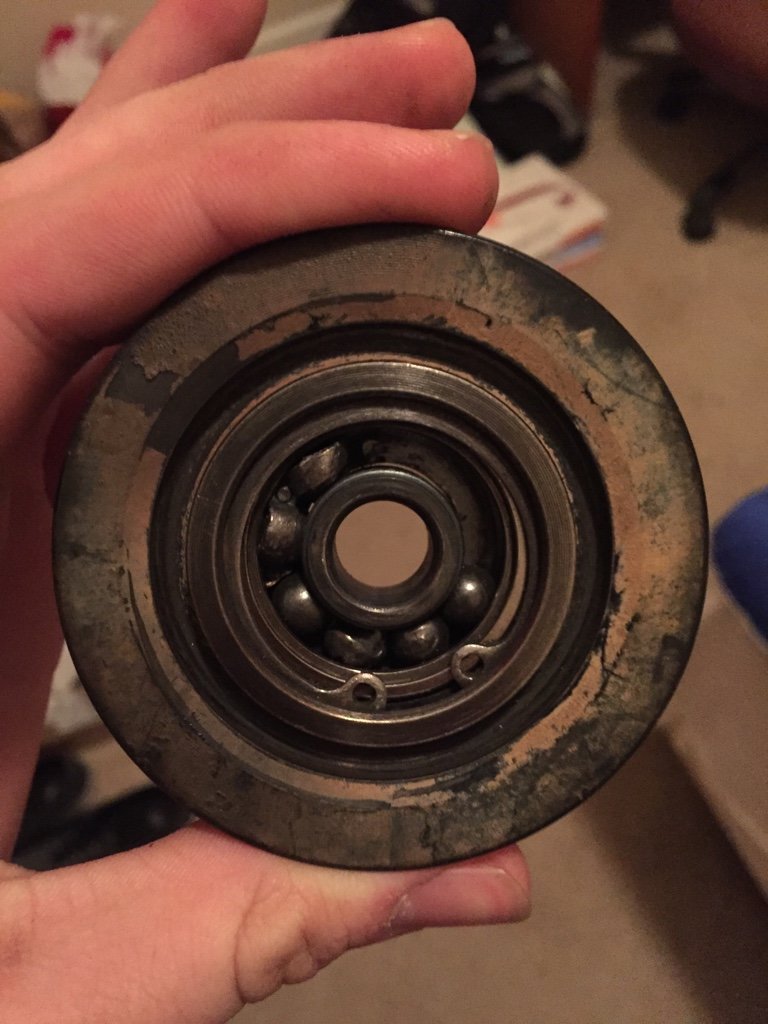

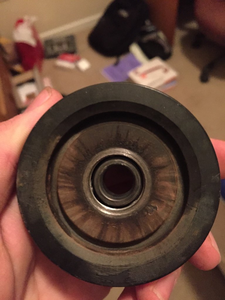

    hmmm, my rig has been making an awful sound. A loud whine. And it gets louder as I turn the wheels. I haven't noticed any issues with steering, its just a loud whine. I'm thinking its the pump. I did put power steering fluid in for a couple of weeks before I realized I am supposed to use ATF fluid. I wonder if that damaged it??
  13. May 28, 2015 at 10:14 AM
    BYJOSHCOOK
    BYJOSHCOOK Mr. Mojo Risin
    Jun 9, 2013
    #105887
    27,924
    Josh
    Woodstock and Alpharetta Ga
    2000 SR5 4WD Lunar Mist
    Check Out My Builds
    Could check the pulleys, mine was making a horrible noise then the AC belt snapped because of that pulley was fried

    hmmm, my pulleys are caked with mud. I wonder if that's the issue

    I got a pic in my build somewhere of what my pulley looked like. Stiff as hell and was black on the back a little...

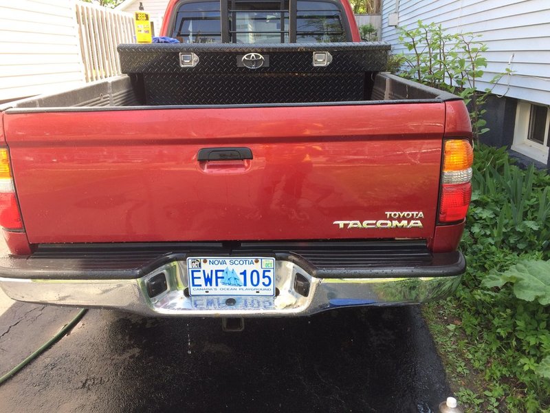

    Took off my old tailgate badges because they were rough. Chrome was peeling and they were dirty. Went a little 2nd gen-ish
    Chipskip and Deathbysnusnu like this.

    Only thing that I like from the second gens :thumbsup: looks good

    154a968e879026962bf3f79ca7f83885_babec1cafa1686bc9a7e2e8bc3ed3486e21edc37.jpgd01e0bbad44227a9e803d22a0d636e90_7848687955b92e76467909405810e8894dc643ff.jpg
    Found the pictures

    Or do a PS flush and clean out the screen in the bottom of the pump :notsure: I did all of that just to find out my pulley was bad haha
