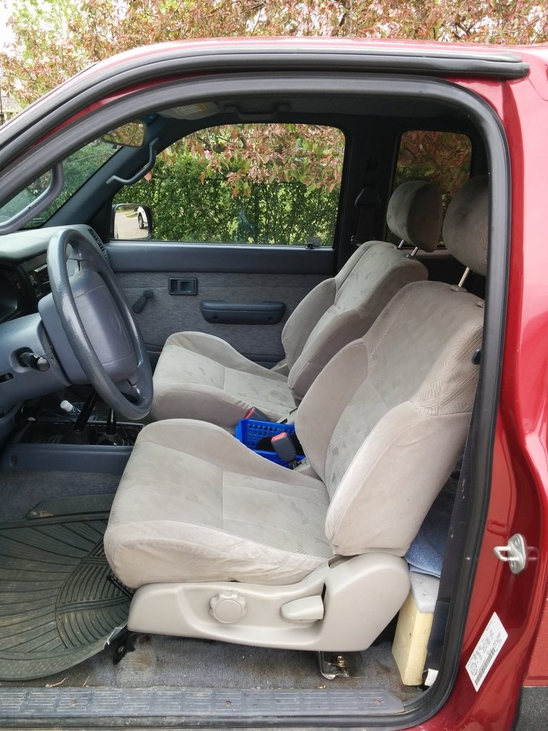

    Was that a direct bolt in, or did you have to modify them?

    same as the stock tacoma bucket seats i had before. they slide and fold just as far, only difference is when sliding the 4runner passenger seat forward its not spring loaded, so i have to use two hands to get to the back whereas the tacoma pass seat was spring loaded so i could slide it forward with one hand
    3 out of 4 mounts were direct bolt in, the fourth mount had to be modified - you can see it in the pic its the rear mount closest to the door. a small square section of flat steel plate was welded to the bottom of the seat mount then a hole was drilled in the plate to bolt it to the floor. the holes on the 4runner seat and where it bolts down to the floor was only about an inch or so apart, no height spacers were needed. i didn't have all the tools to do this so a buddy from a local 4x4 group helped me out

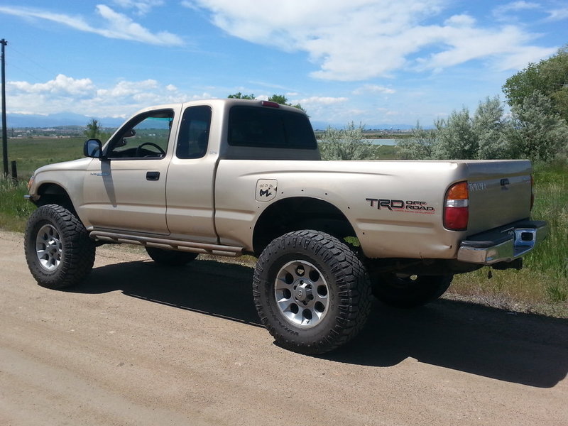

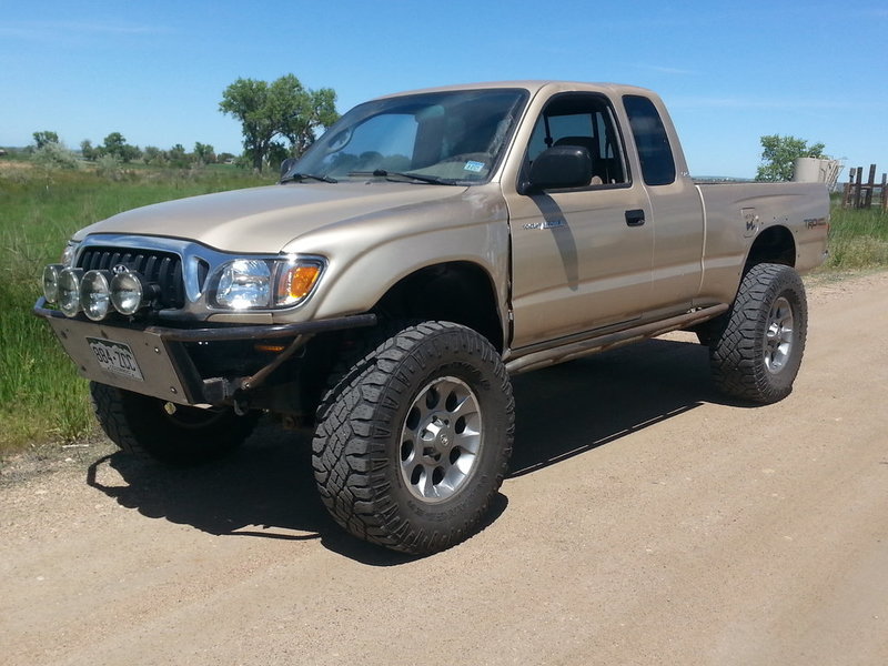

    Finally finished with fitting the 35'suploadfromtaptalk1433076563414.jpguploadfromtaptalk1433076630665.jpg

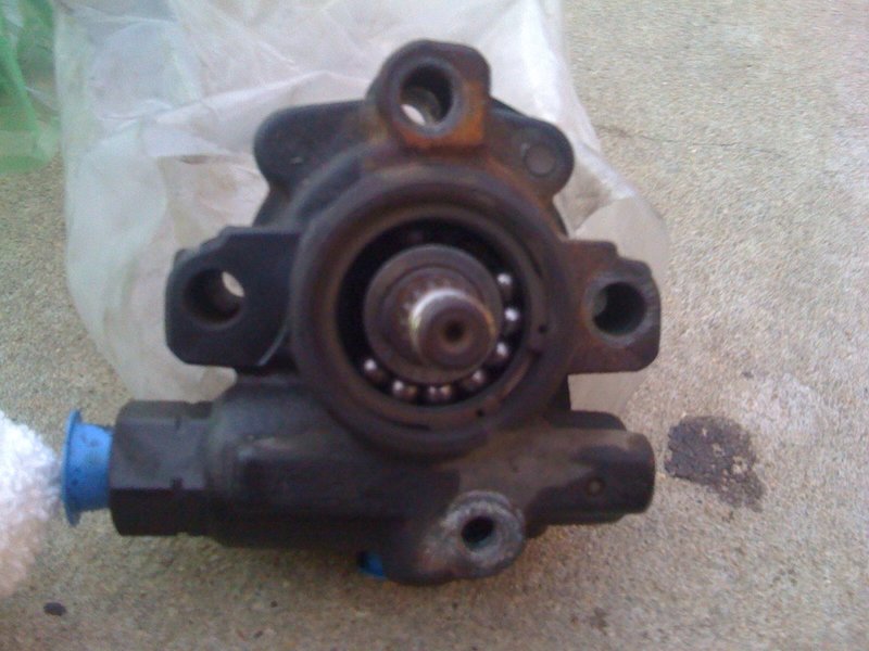

    I let a friend use my truck for a month - right after we installed the Excedy clutch kit and a new starter, I didn't even get a chance to drive it first. When I got it back, I noticed a growling noise and the steering seemed a little rough. Gonna drain the power steering fluid and clean the filter to see if it helps - if not, I guess I'll have to replace the pump :(

    It's been several years, but mine did this.

    Never seen a power steering pump do that before.

    Looks good Tim. I need to swing by and come and looks at those personally. And we can talk shocks

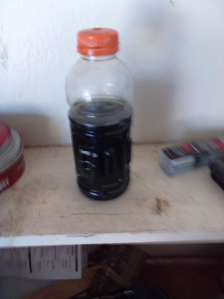

    On Sat, I change my brake fluid on my new to me taco. Its a littel dirty. lATTACH=full]713813[/ATTACH]
