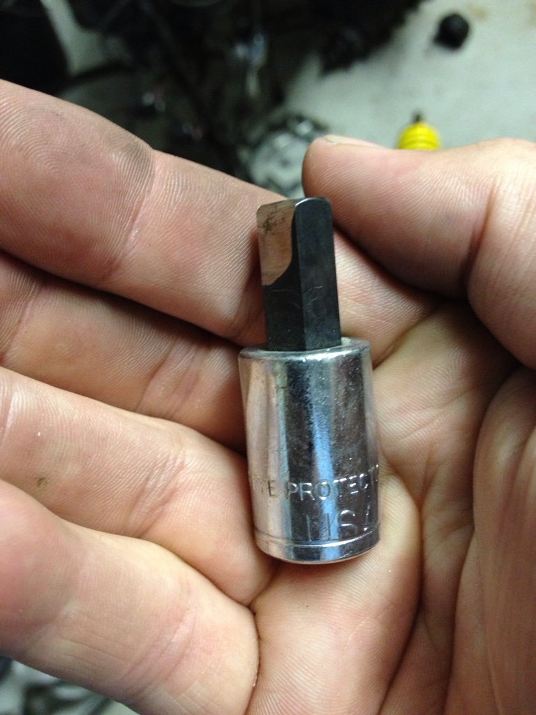

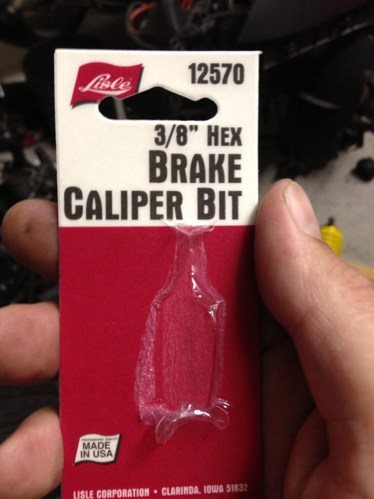

    Maybe make one of these.
    Out of one of these.

    This is a pickle fork, you can get them for a air hammer also

    ^^^ thats what i used on mine.

    There used for more than for ball joints lol :)
