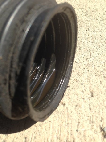

    Got an alignment yesterday after replacing tie rods and lower ball joints. Couple of questions after replacing the tie rods...
    Both inner tie rod boots had some oil puddled up in them. I'm guessing this is from a rack leak? Is it power steering fluid?
    I also noticed up/down play in the driver side rack end. Do I need a new rack or is there something less major I can replace?
    I'm not sure how long both the leak and play has been there, but everything feels fine while driving and the shop was able to get the alignment in spec. Is this something I should try to address asap? I can post a video of the play in the rack end if needed.

    yea the leak is power steering fluid.. seal on both ends of the rack fail (wear and tear). I too found some excessive movement on the drivers side as well after launching it at Pismo trying to get some air this weekend. Coming back home felt some vibration in steering wheel over bumps, both inner and outter tie rods are ok. I wonder if i can do a yoke adjustment and help with that play?

    In your case since rack is leaking, id recommend replacement

    Damn...one thing gets marked off the list only to add another haha but it may be awhile before that gets knocked out. Thanks for the reply!
