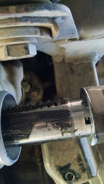

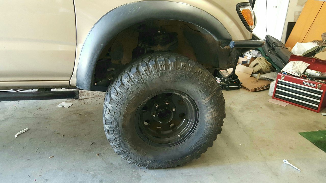

    Is this bad/normal?

    Can't tell what it is.

    Guess i should have explained more, lol steering rack.

    I still see nothing wrong..

    X2. I think something would be wrong if you were seeing PS fluid but that just looks like grease. :notsure: @nagorb

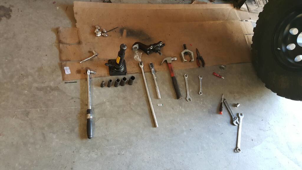

    Oh for heavens sake, I forgot to put the damn rubber gasket boot thing on the new lbj. Is it bad to pop the ball joint out and add the gasket? Looks like an important piece to keep elements out, so I want to put it in there.

    Looks like grease, but is there supposed to be grease there? I figured the gear was lubed buy the atf. I was thinking it was just atf sludge.

    Nm I just popped it out and put boot on. Hope it's ok :notsure:

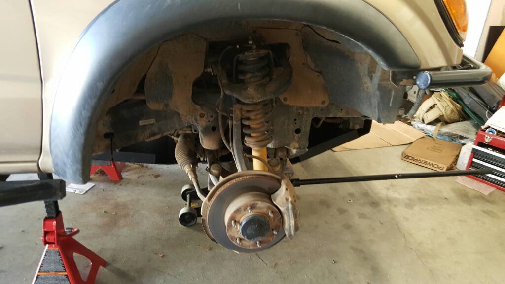

    Stayed organized for 5 mins:d472a0938f49040d1467a5034fd126ef_015f82e44207a9c94deb897ccd6463929282e5d7.jpg
    Two hours on the nose later:
    I do however regret the bottle jack falling on my head. Dropped some serious F bombs haha.

    For those of you guys replacing your lbj, what are the sighns they need to be replaced? I ask because i get a lot of steering wheel play when going over 40mph and im about 50% that its my lbj. Would i have to replace them or is it something else?

    I'm no expert but that sounds like could be your rack bushings. I changed mine out because I use them hard from time to time, and pretty sure these are the originals at 12 years/90k miles. One boot was torn and was puking grease. Decided to just do them both, might as well.

    No it's grease. No ps fluid goes in there. If there is..then you have major issues.
    Yea your fine. Doesn't hurt it.
    Every 90k you should replace them. If the boots are torn. Replace them.
    And steering play could be the ball joints but most likely steering rack bushings.

    Wheelers has the energy poly bushing kit here for your rack: and then I would check with camelback toyota for the ball joints. I got both shipped to my door for like 180. My local dealer wanted 250... Definitely worth getting from the camelback online store.

    Awesome thanks. U know what kind? Regular old moly grease?

    I don't but that's what Id put on it. Doesn't need much though.
