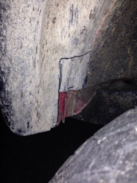

    Just did the pinch weld mod on my passenger side preparing for my 285's that are being shipped. I need some help. I cut the plastic about 4 inches up and the across. That is where the big noticible pinch weld is. I used a dremel to cut the pinch weld ever inch or so and bend it over. Should this clear the 285's? Or do I need to cut up more?

    You had to cut for 285s? o_O

    285/75/16 yes. Everyone I heard from say YES it's a must to cut and hammer the pinch weld

    Only 1 way to find out
    But from what ive experienced and heard it depends on actual size of tire(all tires are not the size they say they are)
    Rim
    Wheel spacers or not
    Suspension
    And alot of thing like wieght from bumpers or passengers and what not
    Easiest way is to just bash it as far as you can out of the way and then just mount the tire and see if it rubs

    Gotcha that's what I figured. They are BFG KM2 285/75/16 on 16x8 off-22 bs 3.625
    I have 3" lift and no wheel spacers will be used. Stock bumpers.
    ACTUAL TIRE SIZE - 33.1

    More than likely youll be fine then
    But i havnt run km2's so not sure
    Im sure youll rub a heck of a lot less then i do right now though
    3" lift
    305/70r16x10
    1" wheel spacers
    Just got 1/4" spacers im swapping in and a 2"bl though so im trying to sort mine out too

    Alignment's a big factor, but if you're going to wheel, you've got a long ways to go. I did quite a bit more than that, including cutting off a majority of the pinch weld for 255/85s. Ended up having to cut further up, and hammer everything back.
    Just did version 2.0 after I got tired of rubbing with 295/75s. Basically as much as you can do without tubbing, including cutting as much as possible, copious amounts of time with a 4lb BFH, and cleaning everything up with a flap disk and seam sealer:
    Regardless, I would suggest cutting off all of the pinch weld as opposed to hammering it down.

    darn. I will be doing some mild wheeling. So I reckon I need to get the dremel back out. I'm going to under coat it when I'm done so it stays protected. I'm in TX so rust is no issue but mud inside the opening is

    I'd just cut it off too. But your not on a super wide tire so probably be okay. Took me 4 separate session to make mine not run back when I was on 33x12.5s
