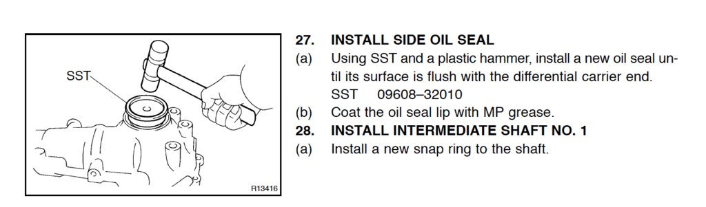

    98 tacoma 4wd leaking oil out of front diff right where the cv axle enters the diff - I'm replacing the axle/diff seal tonight, on the drivers side do i push that seal all the way in or just until its flush with the diff surface?
    i plan on installing it the same way the original one im removing was, but in case it gets mangled while pulling the cv out i'd like to know what its the proper depth to install the seal

    I had that leak a couple months ago. Passenger side you only install the seal until it is flush with the opening. Driver side I believe you push it in all the way. Don't quote me, I only had the passenger side leak.

    98 Taco Max[QUOTED] likes this.

    Guess I was wrong then... Haha
