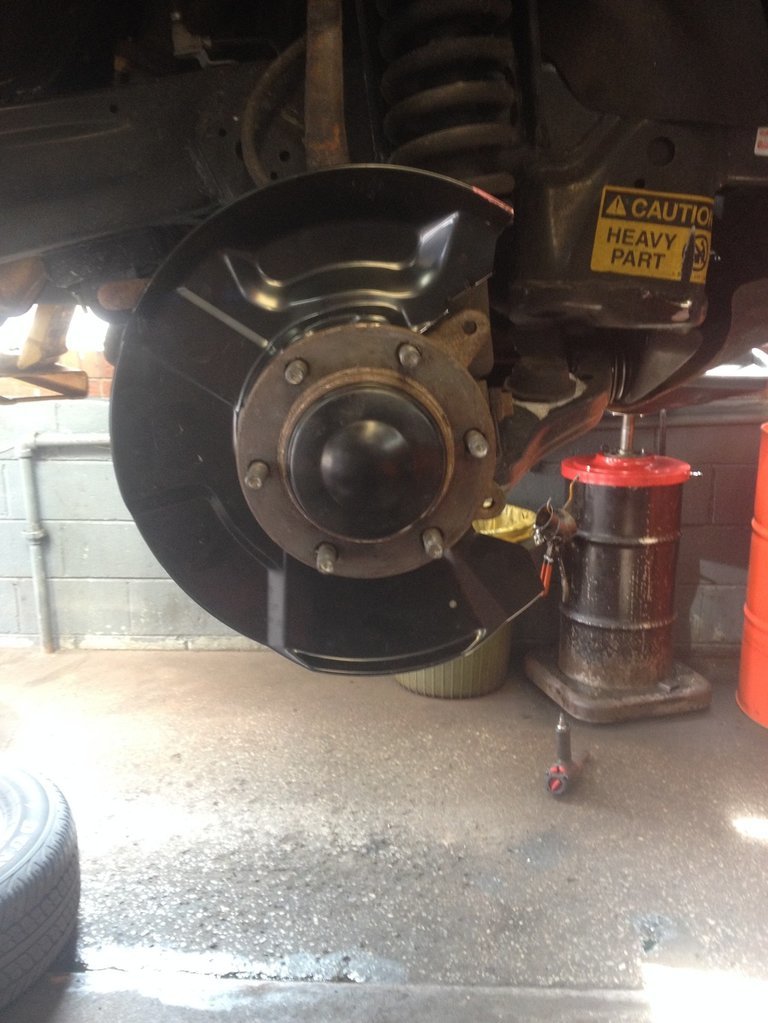

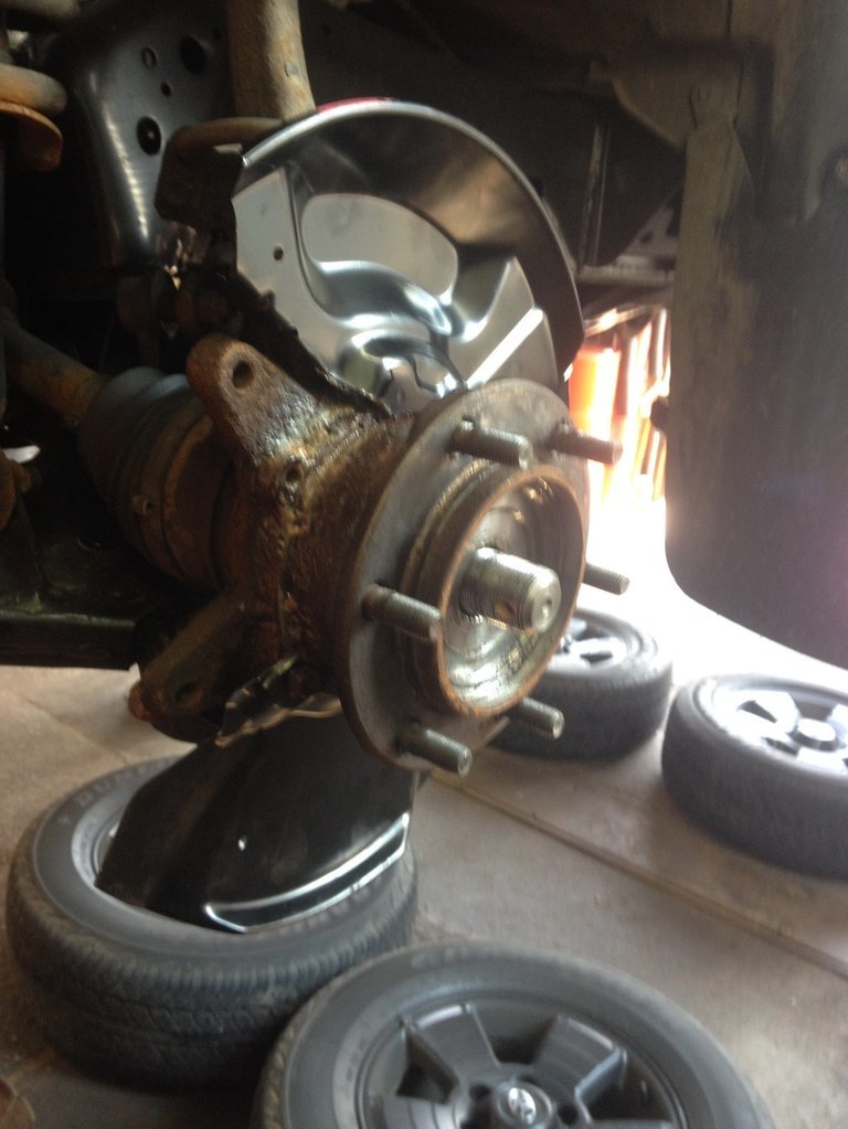

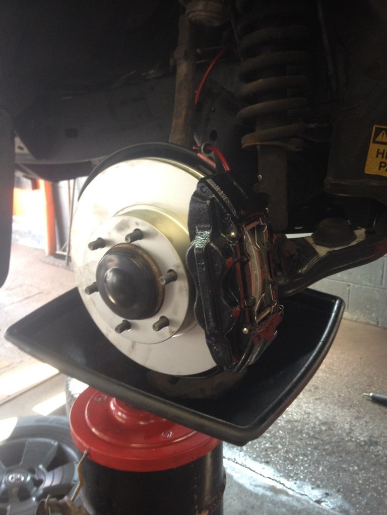

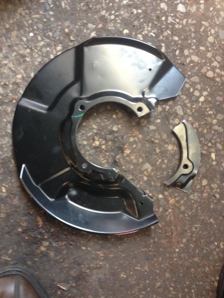

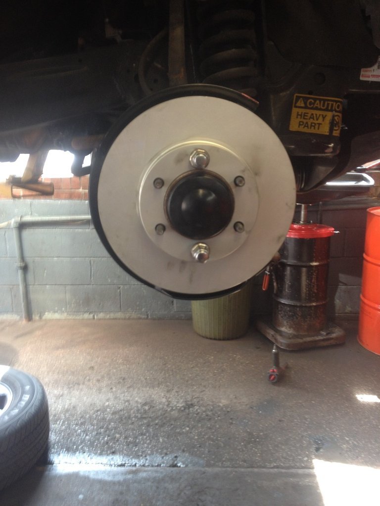

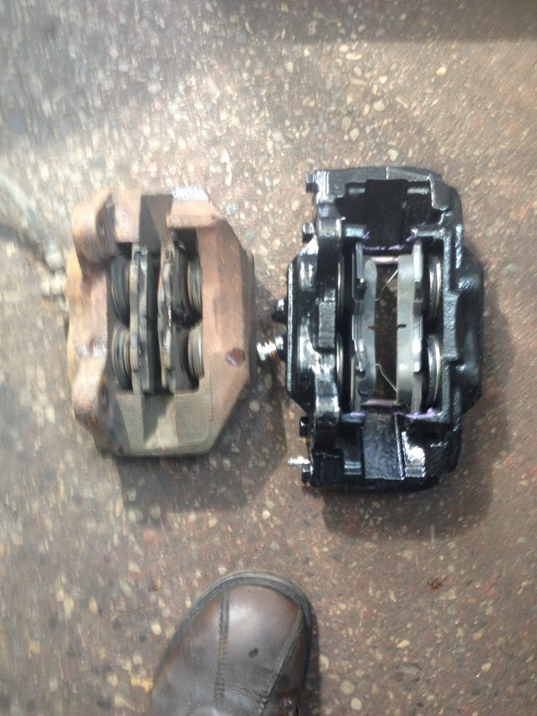

    I did the Tundra brake upgrade on thursday
    I got the tundra backing plates as well cause im anal like that, plus my originals were kaffed anyway
    16A24F66-9310-4EB7-8F5A-988C37248B6C_zps_30bb545c022a0280dbbb188028a5db339acb5252.jpg
    Plus they were only $18 at the dealer, but thats canadian so prolly only $3 south of the border.
    I just cut a section out to get it around the hub
    1283D952-D9E2-438A-BBE5-407C687C78E5_zps_0c8d946d6a090ae9fceebb32b21157930283766b.jpg AEED5DB9-C6B2-4DAA-99E7-E7C1C85ECF81_zps_62c0be5af8acf8ffff55570d4c36f939c146606f.jpg 1BFB58D6-B717-4931-B731-0857FB6C2702_zps_57a9bd5056a6cfc8c130a17a190e0b5f7463a8f5.jpg
    EF334058-A6C1-42AE-AB09-4B95A1382537_zps_6305f60035e1c225cd0546bfdd807e8651e25783.jpg 39010E04-8E03-436D-9EB3-C0FD53599D6B_zps_1ce15e6db0a9ad4768b6f59e1662aa0dce992aa1.jpg 5D18DC72-19F7-4070-A2DF-17DA23867405_zps_6ea77add5104ef65f4058d23f8cdf14780c15899.jpg CC0D70CC-C7EE-4C0C-8886-61282C93CC58_zps_f4a983600297f7c29c1ec9587a9c42e5d3f3e1fe.jpg

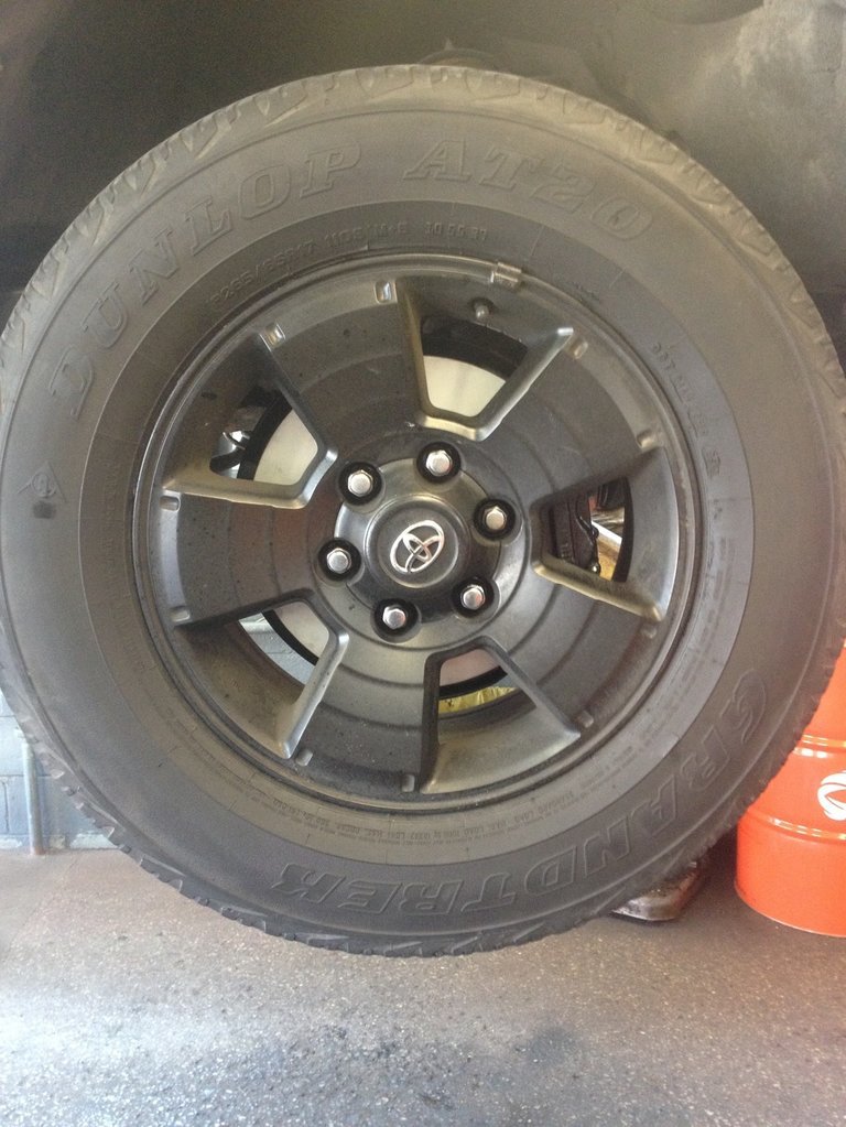

    They fill up the wheels nicely

    Looks really good. I paid like 40 for each of those dust shields. Couldnt find them any cheaper at the time. Lol.

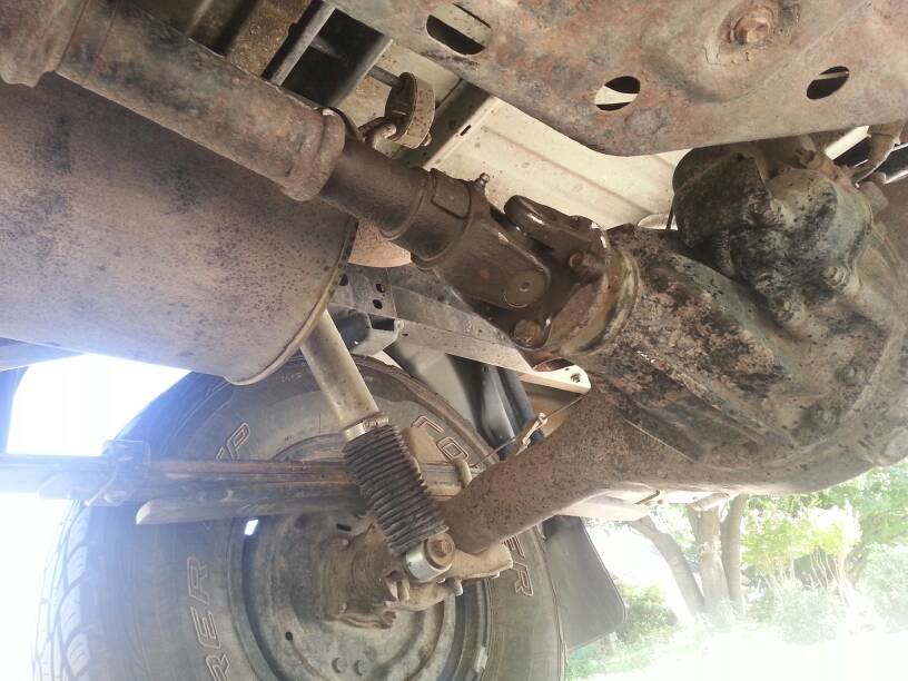

    Actually, the rear shock travel is just about perfect with those springs. It may not look like it from the camera angle but the springs are not flat at all and give me 3" of lift in the rear.
    Yeah, I was referring to the leaking axle seal. It took out the bearing and the brake shoes on that side too. Sorry about not being clear.

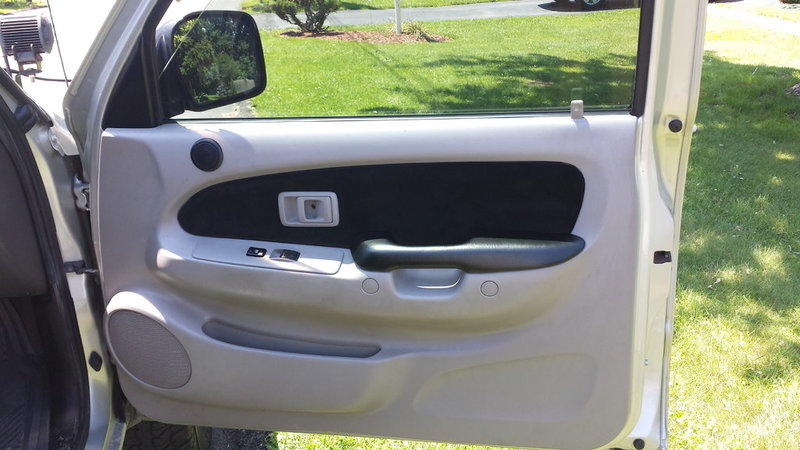

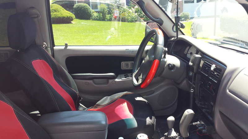

    Painted door panels cloth inserts from gray to black 20150711_140420.jpg 20150711_140445.jpg 20150711_140401.jpg

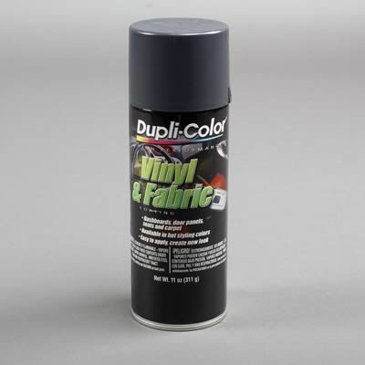

    Looks nice. What kind of paint did u use for the cloth?
    Are the fibers gritty and stiff now?
  13. Jul 11, 2015 at 2:01 PM
    muddog67
    muddog67 Well-Known Member
    May 10, 2014
    #129529
    2,255
    I used this stuff , It works great , saw it on you tube . It is very soft to the touch no grit Dupli-Color.jpg
  14. Jul 11, 2015 at 2:01 PM
    muddog67
    May 10, 2014
    #129529
    2,255
    I bought it at a auto parts store
  15. Jul 11, 2015 at 2:04 PM
    paquu
    paquu Well-Known Member
    Mar 13, 2013
    #99670
    406
    RI
    02 doublecab fj trm rims, roof led bar
    42" LED bar
    Oh cool. I used that on my valence bumper but never on fabric. Wondering how itd come out. Now i know :)
  16. Jul 11, 2015 at 2:06 PM
    muddog67
    May 10, 2014
    #129529
    2,255
    Works great , I was very pleased with the outcome

    That's a clean under carriage :drool:

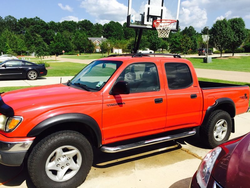

    Finally got around to spraying my flares

    Nice. What'd you use?
