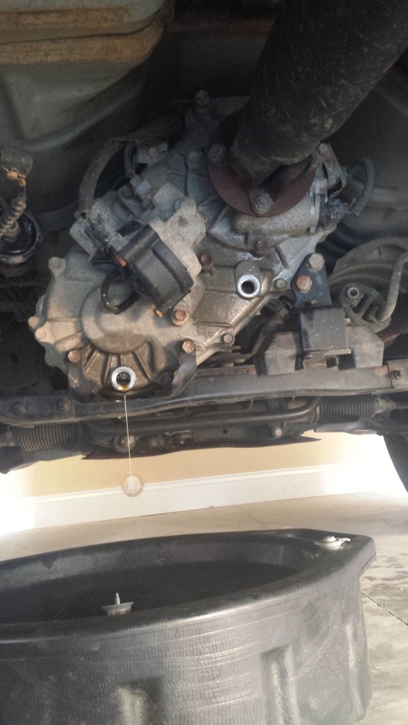

    Drained and refilled the tcase with Mobil 1 synthetic. Fluid looked ok but I have no clue when the PO changed it last. Front diff is all that's left and I'm good to go for a while

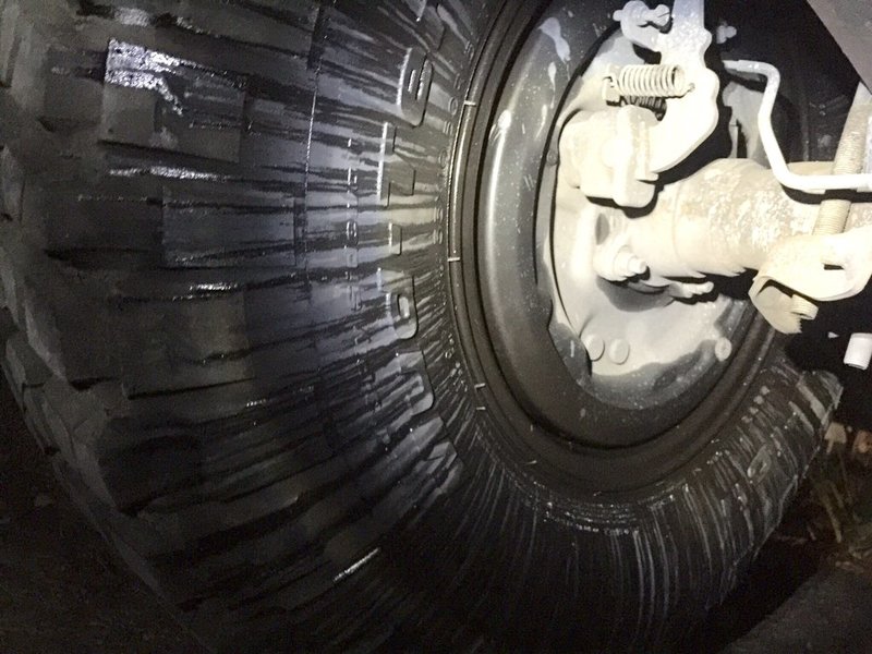

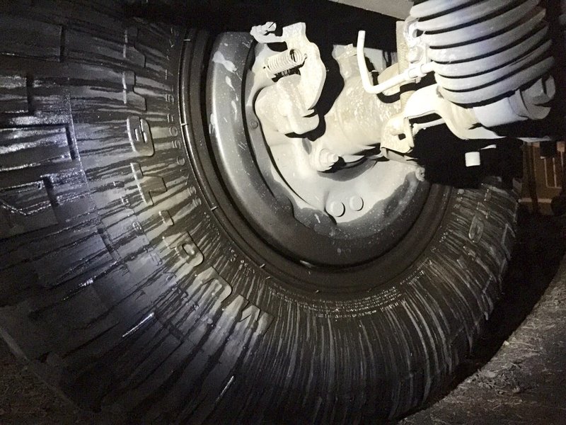

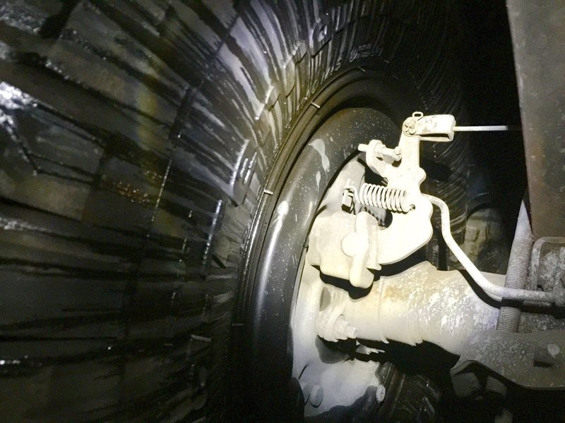

    Do the 3 pics attached look familiar to anyone??? I have oil all over the inside of the driver side rear tire and hub.
    Does it look like a rear axle seal leak?
    Shocks are fine, brake fluid isn't leaking. Haven't taken off the tire or hubs yet to get a good look, just asking for thoughts based on the photos.
    I have noticed small puddles of oil on my driveway but it only leaves a puddle when I take off out of the driveway.

    Oil is leaking from the axle, the axle seal is the common culprit.

    I'm sure it's the axle seal. well crap!
    Anyone have experience on how long I can drive it as long as the Diff fluid does t get too low?? I'm hoping to be able to drive it to work tomorrow and then replace the seal on Saturday.

    Best bet is remove the fill plug and visually/physically check fluid level.

    Based on all the pics being posted this summer, that does look like the rear axle seal leak.
